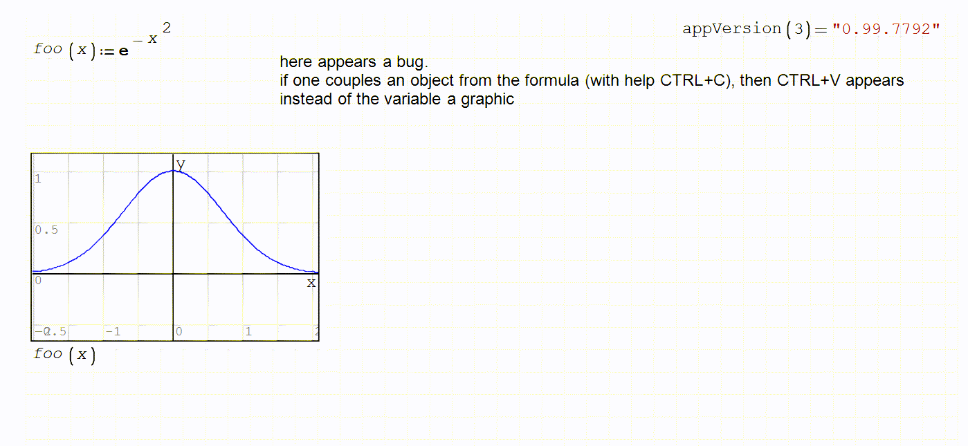

Dear SSMath Developer,
I think the SSMath version ( "0.99.7792" ) has a bug.
If one couples an object from the math. formula (with help of CTRL+C), then CTRL+V, then appears instead of the variable at the page a graphic
Best regards,
Andrey

This is because the plugin implements
public string[] SupportedClipboardFormats => new[] { DataFormats.UnicodeText };
Hence when a plain text is passed the plugin handle the action.
Guess would be needed a "paste as" when multiple plugins are available for such task, with the built-in as default (if any).

Is the plugin that is shown when you paste the data
So in this case is XYPlotRegion probably

I've corrected plug-ins to disable handling of text from clipboard by default (as I see it was activated by mistake because of using the same code templates).
So issue is gone. One just need to update installed plug-ins. Note: the latest SMath Studio beta must be used.
