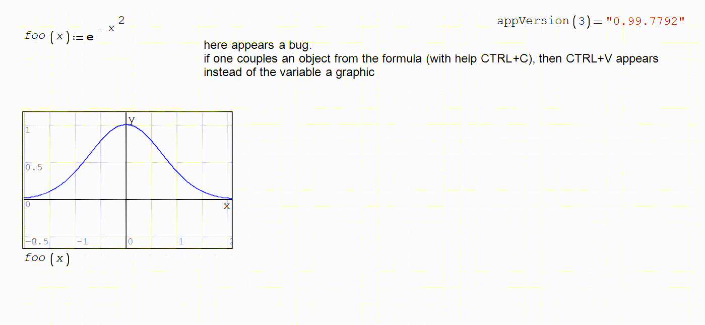

Dear SSMath Developer,
I think the SSMath version ( "0.99.7792" ) has a bug.
If one couples an object from the math. formula (with help of CTRL+C), then CTRL+V, then appears instead of the variable at the page a graphic
Best regards,
Andrey

This is because the plugin implements
public string[] SupportedClipboardFormats => new[] { DataFormats.UnicodeText };
Hence when a plain text is passed the plugin handle the action.
Guess would be needed a "paste as" when multiple plugins are available for such task, with the built-in as default (if any).
Hello Davide,
thank you for your answer.
Now I have the dilemma, which plugin is responsible for this effect...
I have to turn on and off each plugin step by step to determine it.
Best regards,
Andrey

Is the plugin that is shown when you paste the data
So in this case is XYPlotRegion probably

I've corrected plug-ins to disable handling of text from clipboard by default (as I see it was activated by mistake because of using the same code templates).
So issue is gone. One just need to update installed plug-ins. Note: the latest SMath Studio beta must be used.
