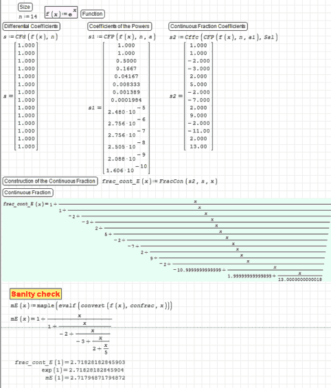

#1 Опубликовано: 12.02.2020 01:04:02
CBG
CBG
Four examples of Continuous Fractions
Continuous_Fractions_SS7251.sm (79,76 КиБ) скачан 1248 раз(а).
Continuous_Fractions_SS6179.sm (76,96 КиБ) скачан 1222 раз(а).
Carlos
frapuano 12.02.2020 06:46:00, NDTM Amarasekera 13.02.2020 05:10:00
#2 Опубликовано: 12.02.2020 09:17:10
Four examples of Continued Fractions
Thanks Carlos ... works well.
More from Maple ... Jean
Symbolic Convert Parfrac Primary FNCTS.sm (27,81 КиБ) скачан 1200 раз(а).

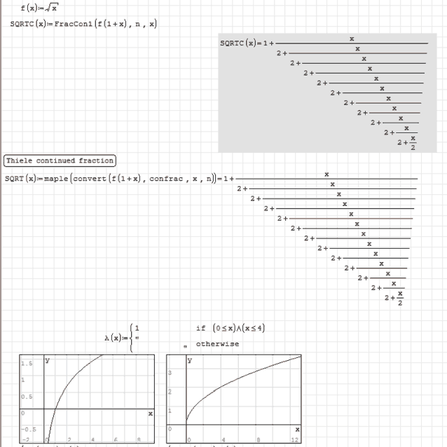

#3 Опубликовано: 12.02.2020 17:51:43
CBG
CBG
Hola Jean
Thank you very much for your examples, they have helped me to correct
a fault that was presented in the ACOS (X) function, where the value
of "Phi () / 2" was not included.
I have merged all the algorithms in a single function for ease of use.
All the examples you provided work perfectly with the algorithm for
the conversion of function to a continuous function.
SMATH STUDIO VERSION 7251, DOES NOT ACCEPT THE ACOS (X), ASIN (x) AND
ATAN (X) FUNCTIONS FOR MAPLE, GIVING THE "EMPTY STACK" ERROR.
Continuous_Fraction_algorith_SS7251.sm (76,87 КиБ) скачан 1135 раз(а).
Continuous_Fraction_algorith_SS6179.sm (77,56 КиБ) скачан 1212 раз(а).
Carlos
Maybe Viacheslav can doctor the sick Maple.
Few more in there Carlos ... Jean
Symbolic Convert Parfrac Primary FNCTS.sm (101,16 КиБ) скачан 1237 раз(а).
