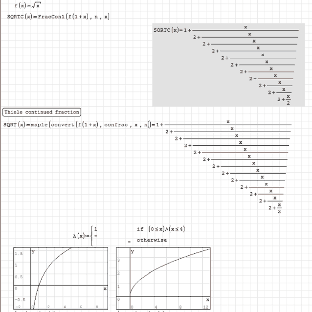

Four examples of Continuous Fractions
Continuous_Fractions_SS7251.sm (79.76 KiB) downloaded 1414 time(s).
Continuous_Fractions_SS6179.sm (76.96 KiB) downloaded 1385 time(s).

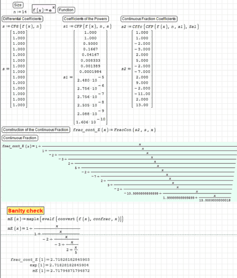

Four examples of Continued Fractions
Thanks Carlos ... works well.
More from Maple ... Jean
Symbolic Convert Parfrac Primary FNCTS.sm (27.81 KiB) downloaded 1369 time(s).

Hola Jean
Thank you very much for your examples, they have helped me to correct
a fault that was presented in the ACOS (X) function, where the value
of "Phi () / 2" was not included.
I have merged all the algorithms in a single function for ease of use.
All the examples you provided work perfectly with the algorithm for
the conversion of function to a continuous function.
SMATH STUDIO VERSION 7251, DOES NOT ACCEPT THE ACOS (X), ASIN (x) AND
ATAN (X) FUNCTIONS FOR MAPLE, GIVING THE "EMPTY STACK" ERROR.
Continuous_Fraction_algorith_SS7251.sm (76.87 KiB) downloaded 1294 time(s).
Continuous_Fraction_algorith_SS6179.sm (77.56 KiB) downloaded 1379 time(s).
Carlos
