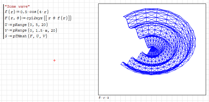

Hi. There are several variants for the triangular meshs. This is one.
pTriMesh.pdf (459,2 КиБ) скачан 783 раз(а).
pTriMesh.sm (29,35 КиБ) скачан 1398 раз(а).
