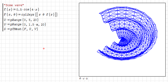

Hi. There are several variants for the triangular meshs. This is one.
pTriMesh.pdf (459.2 KiB) downloaded 915 time(s).
pTriMesh.sm (29.35 KiB) downloaded 1575 time(s).
