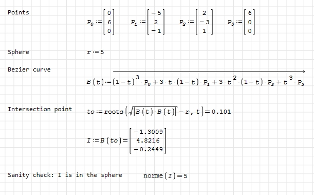

Sphere and cubic Bezier curve intersection points.sm (10,28 КиБ) скачан 1119 раз(а).

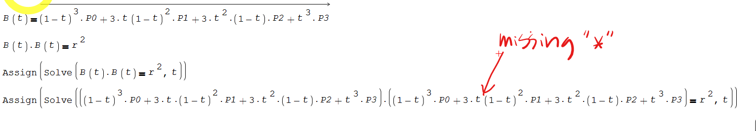

OK, I've fixed the error, but now it says: «r is undefined». Sorry, it's really hard to understand what to do and I can't find any proper docs about it...

WroteI really don't get what's wrong now...
Sphere and cubic Bezier curve intersection points.sm (12,04 КиБ) скачан 1155 раз(а).
There is a missing "*"

Thank you! But what should I do with «r is undefined»? 🤔
You must right-click over your equation, then choose Optimization-Symbolic
WroteAre you sure you are using the option "Symbolic Optimization"?
Thank you very much! It worked! However, the roots are so long... Not sure I can use them... Thanks anyway! 😊
