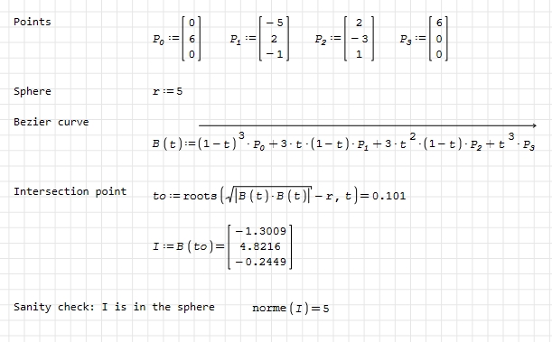

Hi. In the attached how to solve the problem numerically. Notice that B(t) must to be defined using vectorize, because SMath don't expand the scalar by vector products.
Sphere and Cubic.sm (8.86 KiB) downloaded 1215 time(s).

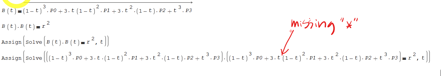

OK, I've fixed the error, but now it says: «r is undefined». Sorry, it's really hard to understand what to do and I can't find any proper docs about it...
Sphere and cubic Bezier curve intersection points.sm (4.62 KiB) downloaded 1275 time(s).
#13 Posted: 9/16/2021 8:43:30 AM
Necronomicron
Necronomicron
0 likes in 8 posts.
I really don't get what's wrong now...
Sphere and cubic Bezier curve intersection points.sm (12.04 KiB) downloaded 1306 time(s).
#14 Posted: 9/16/2021 9:40:26 AM
Oscar Campo
Oscar Campo
135 likes in 309 posts.
There is a missing "*"

Hi. Notice that P0, ..., P3 are vectors with 3 components, not scalars. You can't get the distance with B(t).B(t) using P's as scalars.
