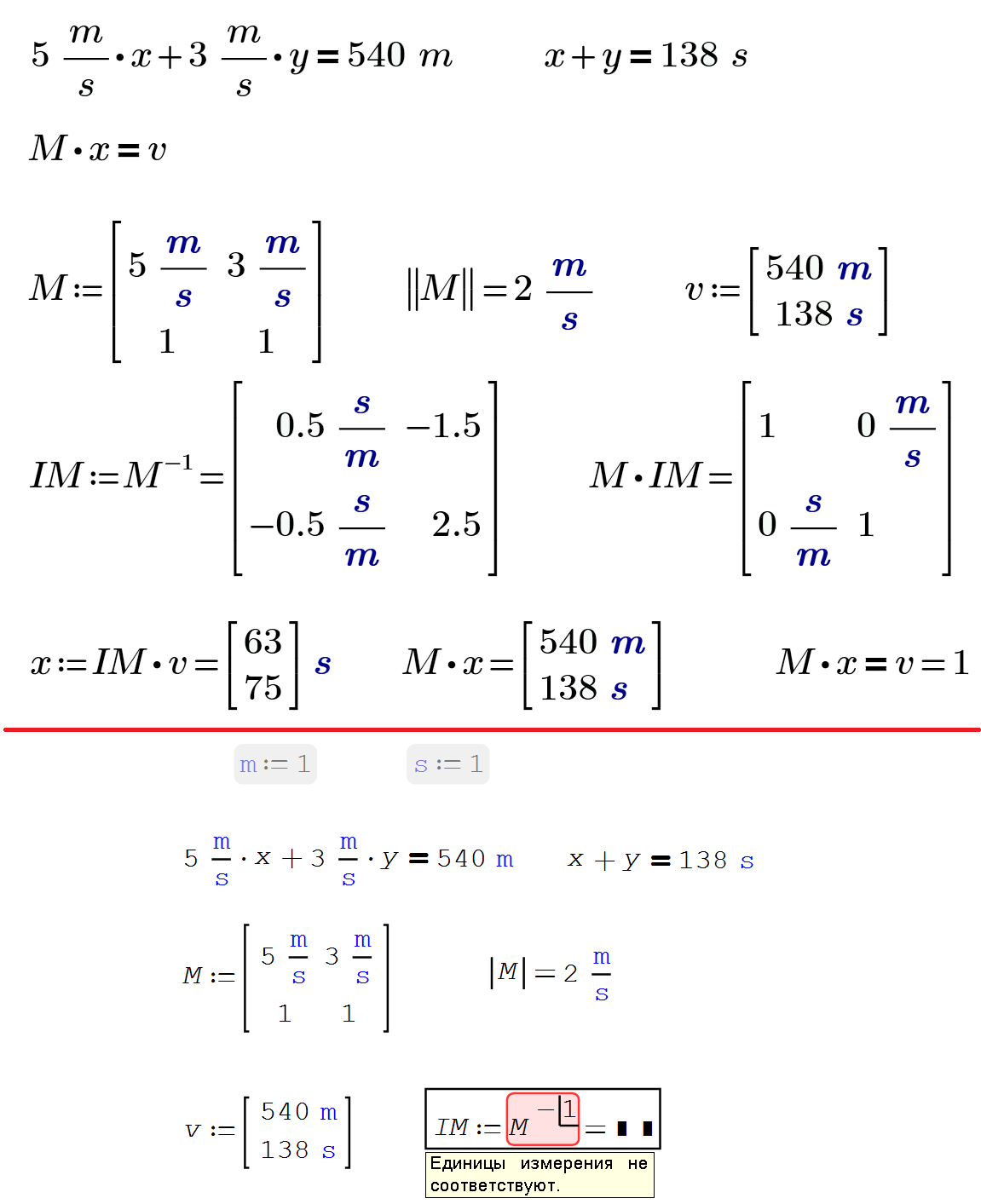

#1 Опубликовано: 21.05.2024 11:45:13
Valery Ochkov
Valery Ochkov
67 сообщений из 716 понравились пользователям.
Mathcad vs SMath
#2 Опубликовано: 21.05.2024 13:44:42

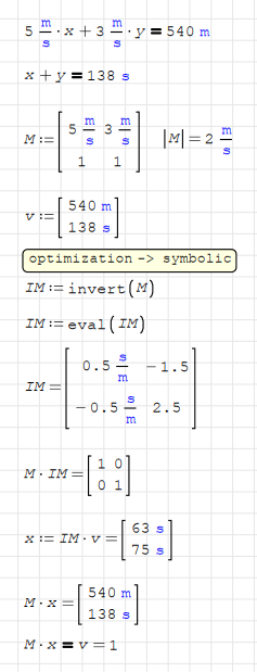

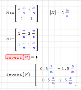

There is invert() function for that but it won't work with mixed units.
#3 Опубликовано: 21.05.2024 17:10:58
Nevermind, I found a way for invert.
Here is your solution.
invert.sm (9,09 КиБ) скачан 1794 раз(а).

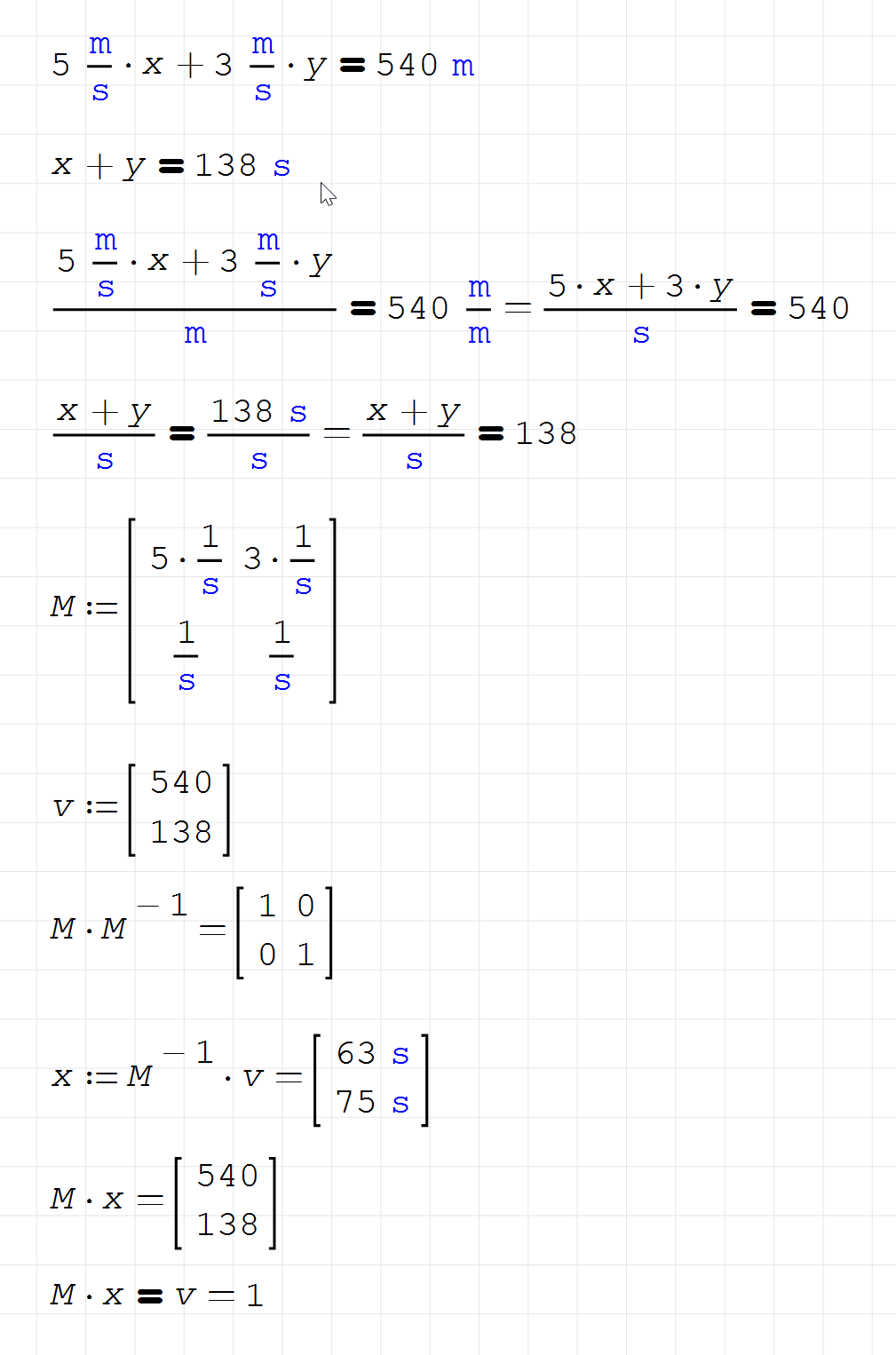

#4 Опубликовано: 21.05.2024 18:19:03
I take inspiration from Overlord
