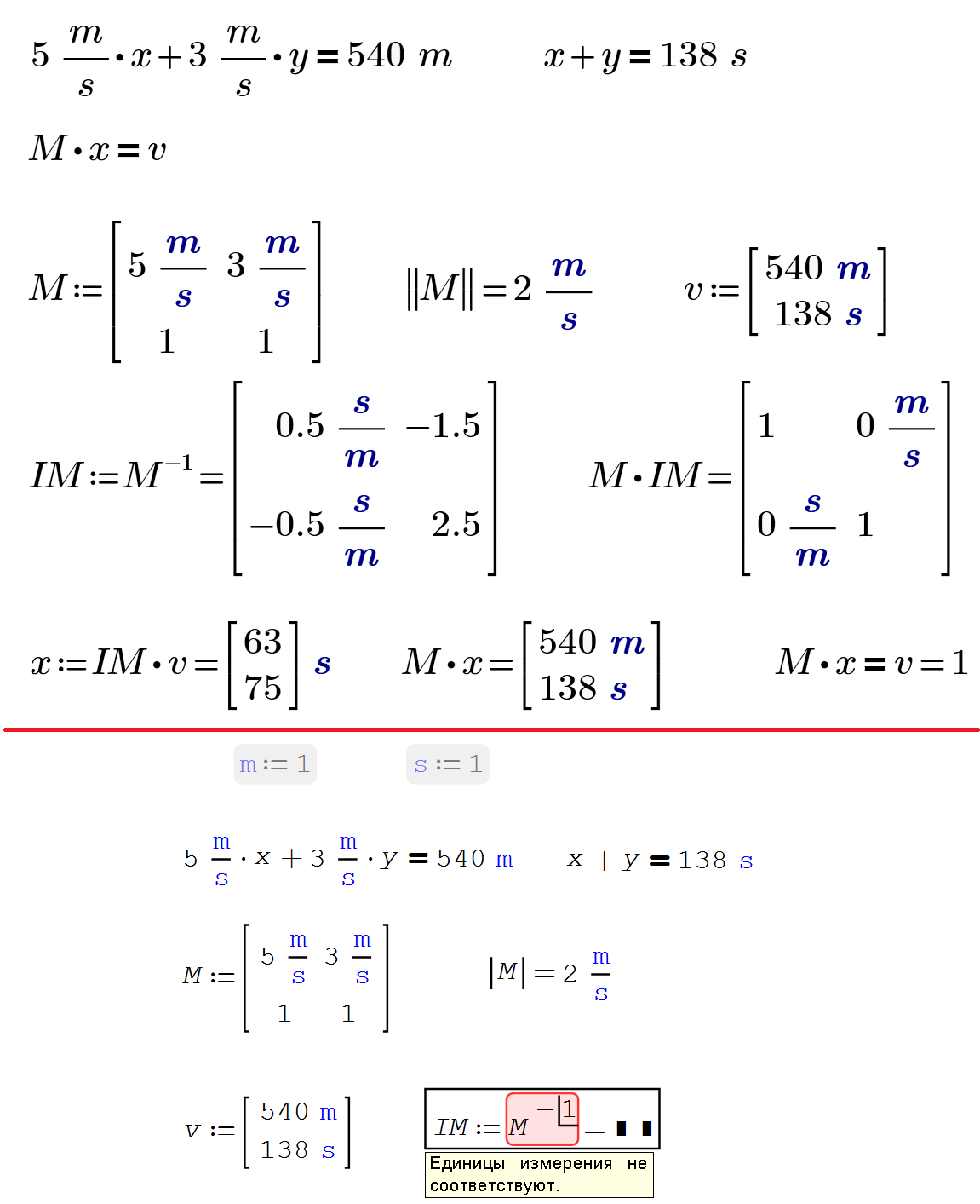

Mathcad vs SMath

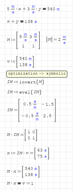

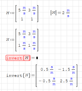

There is invert() function for that but it won't work with mixed units.
#3 Posted: 5/21/2024 5:10:58 PM
600 likes in 1,381 posts.
Nevermind, I found a way for invert.
Here is your solution.
invert.sm (9.09 KiB) downloaded 1794 time(s).

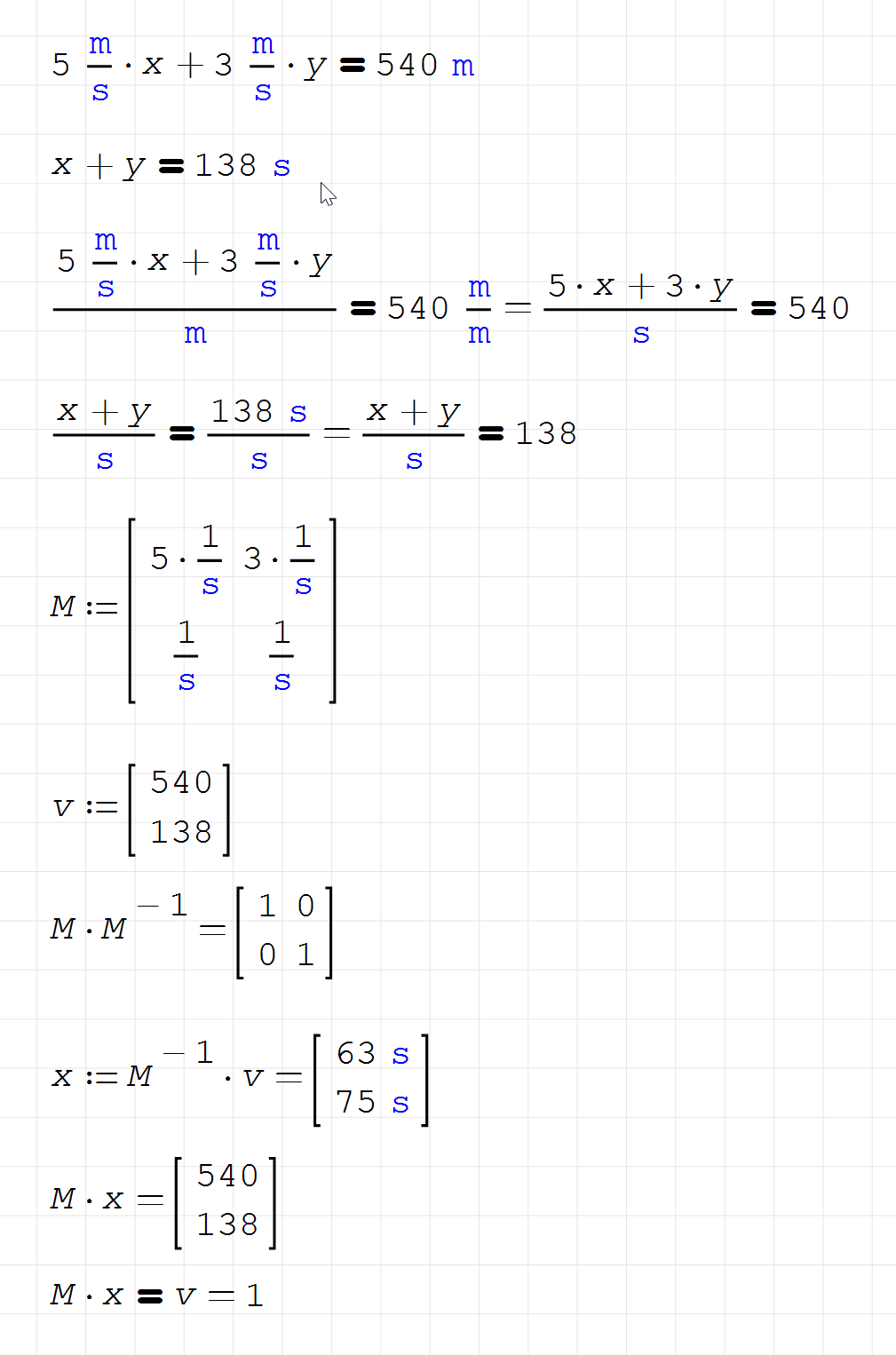

#4 Posted: 5/21/2024 6:19:03 PM
127 likes in 342 posts.
I take inspiration from Overlord
