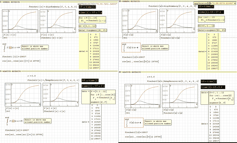

Hello Jean
Apply the recursive Romberg method and the recursive adaptive method to your function.
Integrate Frechet_Jean_CBG_SS6179.sm (52,54 КиБ) скачан 921 раз(а).
Integrate Frechet_Jean_CBG_SS7251.sm (55,26 КиБ) скачан 880 раз(а).
Carlos
Carlos
WroteHello Jean
Thanks Carlos, saved for reference
