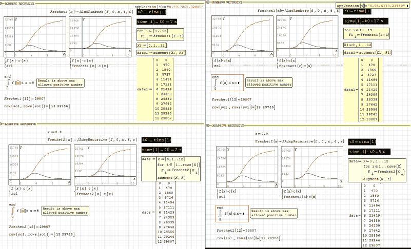

#2 Posted: 11/15/2019 4:21:06 PM
Hello Jean
Apply the recursive Romberg method and the recursive adaptive method to your function.
Integrate Frechet_Jean_CBG_SS6179.sm (52.54 KiB) downloaded 1241 time(s).
Integrate Frechet_Jean_CBG_SS7251.sm (55.26 KiB) downloaded 1219 time(s).
Carlos
Carlos
