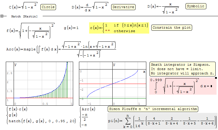

The attached are Engineering documents for publishing at the client level.
For sure, you could de-compact to fill more pages for casual visitor and thus look smarter !
If I have ever seen a Latex usable document: no recollection, I must have been hard drunk !
What is Latex => for useless papers ...
Inst_Mach Number Pitot [PUBLISH].sm (20,33 КиБ) скачан 1461 раз(а).
Pattern Julia Set [PUBLISH].sm (24,83 КиБ) скачан 1455 раз(а).
Inst_Segment Partial Random [PUBLISH].sm (39,03 КиБ) скачан 1448 раз(а).

Inst_Type Pt100.sm (53,8 КиБ) скачан 1651 раз(а).

Pi Mitcher.sm (17,69 КиБ) скачан 1664 раз(а).
