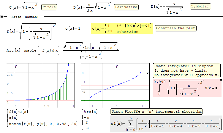

Interesting exercise,but not wrt calculating π.
The greatest Mathematicians broke their teeth on π, even Legendre.
They had horrible formulations. The demonstration is unique from
the "isoperimetres" [Schwab 1813]. The very first "big IBM" got π
from continued fractions. Computing machinery store many constants
[including π] in 40 decimals ... don't know about PC's.
Some years ago, Simon Plouffe [Professor @ UQUAM: Université du Québec
à Montréal], gave this formula. Simon and Neil Sloane do maintain a
huge data base of "Combinatorics" > 100000 sets ...
Pi Mitcher.sm (17.69 KiB) downloaded 1664 time(s).
