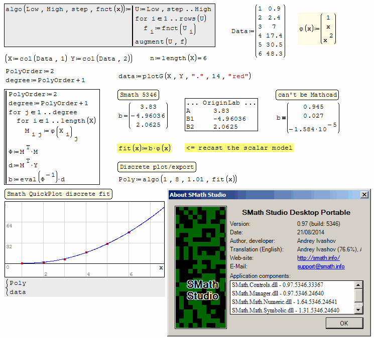

#6 Опубликовано: 19.04.2016 18:38:54
"CBG's format worked great for me (Thank you). I was going through my MathCAD sheets/notes ..."
The question is not if CBG works or not in your installation. The problem is
why my work sheet is not compatible to your version. You say it does not work.
Read the error message "Not set to an instance to compute" . So, how many of
the user created function your version won't read ? W/o user programmed functions,
Smath is just a curiosity.

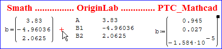

"How simple" from your Mathcad !!! plot and see .
I have same result from OriginLab than Smath. OriginLab was doing gorgeous
fitting much before Mathcad 8/11 , Why? because fitting techniques were developped
between Mathsoft Collabs [especially: Robert, Paul, Jean ...].
"Jean, for the first time, your algo gave me an error".
Yes because your Smath version is not set to read backward version [to be confirmed].
"On a side note, on the picture (very bottom), you define "Poly" at the top of the next graph.
I am olmy familiar with poly and data being on the bottom like the top most picture".
"Poly" is any name to assign the result of the discrete algo.
Cheers, Jean

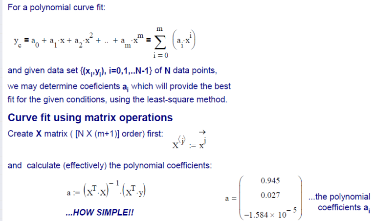

#7 Опубликовано: 19.04.2016 19:08:27
Your Mathcad coding is pure invention. It can't be otherwise than
it was Mathcad 8/11. Where does that big blue note comes from ?

#9 Опубликовано: 19.04.2016 19:22:53
in poly:=, the function needed to be f(_x)
Thank you for pointing out where was the issue (and Jean for the code and Mike for the debug too)
In fact is not a problem of SS version, I opened the file attached by Jean with 0.97.5346 and I got the same error.
Still, I see the screenshot of Jean and I don't understand how it is possible that worked for him.

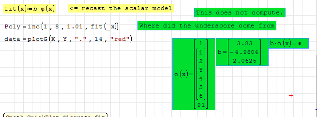

#13 Опубликовано: 19.04.2016 22:08:59
Ruben Sidranski
Ruben Sidranski
Just one character fixes Jean's excellent (as usual) sample
I am look at the fixed file from Mike and comparing it to Jean's original file. The only difference I see between them is the underscore in the function f(_x) in the Poly definition. Totally lost with the
  1. Why the underscore made it work?
  2. What the recasting of the scalar does?
#14 Опубликовано: 19.04.2016 23:11:19
Mike Kaganski
Mike Kaganski
Yes, that's exactly that one character I mentioned above
Цитата
  • Why the underscore made it work?
  • Because the "_x" is undefined. Jean used function-as-parameter feature to pass an algo to a function. SMath requires that in this case, the passed function (here it's f(#)) must have its fictive parameters all previously undefined variables. This is very old requirement (I'm unsure if there ever existed a version without it). As Jean has defined "x" above, it coudn't be used as fictive parameter to passed f().
    Edit: wrong English error message is reported as SS-2324.
    С уважением, Михаил Каганский

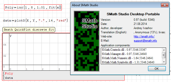

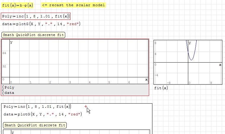

    #15 Опубликовано: 19.04.2016 23:40:33
    Hello Collabs ,
    Here is the screen shot of the attached work sheet.
    My installed Smath 5346 is "as is" from the day it was installed.
    No download update. Why the underscore would make it work on Elsid
    version, can't explain. From what you are saying Davide, it looks
    that if some of the "nightly build" reside in the same machine, it
    broke logical link to user define function, or code incompatibility
    between versions.
    Poly Quadratic 5346.sm (38,23 КиБ) скачан 1324 раз(а).
    #16 Опубликовано: 19.04.2016 23:50:43
    Mike Kaganski
    Mike Kaganski
    This topic discusses the functions-as-parameter thing. You may notice, that it's 6 years old (started 24 Jun 2010), much older than 0.97.5346 (21 August 2014). And yet, all requirements, including requirement that all variables must be previously undefined, are already in place.
    And yes, as expected, Jean's last file opens fine, because it doesn't contain global definitions of x.
    #17 Опубликовано: 20.04.2016 10:26:06
    Ruben Sidranski
    Ruben Sidranski
    Mike,
    Thanks for the explanation
    1. ANSWERED
    The screen shot I posted shows it equals nothing ... Multiplying the vectors with the second one being a vector within a vector does not compute in my brain
    Your Mathcad coding is pure invention. It can't be otherwise than it was Mathcad 8/11. Where does that big blue note comes from ?
    Jean, The Mathcad file I posted in blue does NOT use the same data points, so the polynomial coefficients "b" will be different. I was trying to copy the syntax over to SMath
