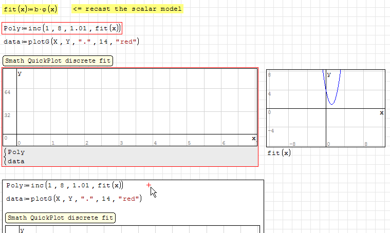

CBG's format worked great for me (Thank you). I was going through my MathCAD sheets/notes ...Curve.PNG

"CBG's format worked great for me (Thank you). I was going through my MathCAD sheets/notes ..."
The question is not if CBG works or not in your installation. The problem is
why my work sheet is not compatible to your version. You say it does not work.
Read the error message "Not set to an instance to compute" . So, how many of
the user created function your version won't read ? W/o user programmed functions,
Smath is just a curiosity.

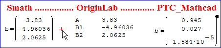

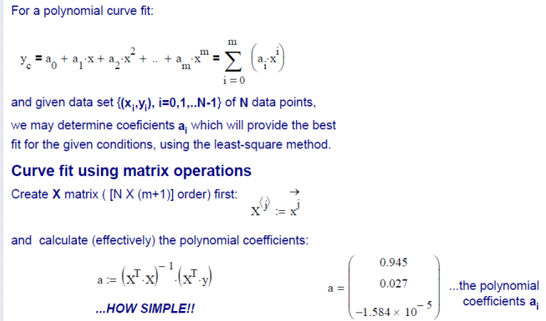

"How simple" from your Mathcad !!! plot and see .
I have same result from OriginLab than Smath. OriginLab was doing gorgeous
fitting much before Mathcad 8/11 , Why? because fitting techniques were developped
between Mathsoft Collabs [especially: Robert, Paul, Jean ...].
"Jean, for the first time, your algo gave me an error".
Yes because your Smath version is not set to read backward version [to be confirmed].
"On a side note, on the picture (very bottom), you define "Poly" at the top of the next graph.
I am olmy familiar with poly and data being on the bottom like the top most picture".
"Poly" is any name to assign the result of the discrete algo.
Cheers, Jean
#7 Posted: 4/19/2016 7:08:27 PM
Your Mathcad coding is pure invention. It can't be otherwise than
it was Mathcad 8/11. Where does that big blue note comes from ?

Jean,
Your coding is phenomenal. Thank you again. Mike found the "character" that was off. I will look for the whole Mathcad sheet and post. I have snippets all over the place and I promised myself to try and be more organized. Not @ computer, but I think in poly:=, the function needed to be f(_x). I took a quick look see but I did not study
Davide Carpi 4/19/2016 7:21:00 PM
#9 Posted: 4/19/2016 7:22:53 PM
1,443 likes in 2,935 posts.
Thank you for pointing out where was the issue (and Jean for the code and Mike for the debug too)
In fact is not a problem of SS version, I opened the file attached by Jean with 0.97.5346 and I got the same error.
Still, I see the screenshot of Jean and I don't understand how it is possible that worked for him.

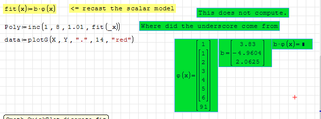

Just one character fixes Jean's excellent (as usual) sample
I am look at the fixed file from Mike and comparing it to Jean's original file. The only difference I see between them is the underscore in the function f(_x) in the Poly definition. Totally lost with the
  1. Why the underscore made it work?
  2. What the recasting of the scalar does?
Yes, that's exactly that one character I mentioned above
Quote
  • Why the underscore made it work?
  • Because the "_x" is undefined. Jean used function-as-parameter feature to pass an algo to a function. SMath requires that in this case, the passed function (here it's f(#)) must have its fictive parameters all previously undefined variables. This is very old requirement (I'm unsure if there ever existed a version without it). As Jean has defined "x" above, it coudn't be used as fictive parameter to passed f().
    Edit: wrong English error message is reported as SS-2324.
    С уважением, Михаил Каганский

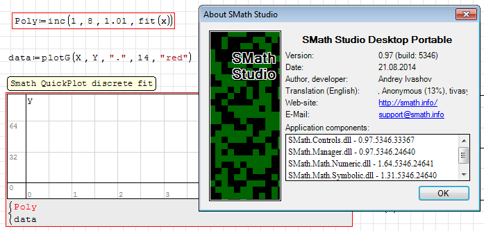

    Hello Collabs ,
    Here is the screen shot of the attached work sheet.
    My installed Smath 5346 is "as is" from the day it was installed.
    No download update. Why the underscore would make it work on Elsid
    version, can't explain. From what you are saying Davide, it looks
    that if some of the "nightly build" reside in the same machine, it
    broke logical link to user define function, or code incompatibility
    between versions.
    Poly Quadratic 5346.sm (38.23 KiB) downloaded 1180 time(s).
    The screen shot I posted shows it equals nothing ... Multiplying the vectors with the second one being a vector within a vector does not compute in my brain
    Your Mathcad coding is pure invention. It can't be otherwise than it was Mathcad 8/11. Where does that big blue note comes from ?
    Jean, The Mathcad file I posted in blue does NOT use the same data points, so the polynomial coefficients "b" will be different. I was trying to copy the syntax over to SMath

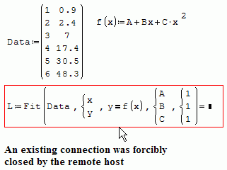

    The Maxima plugin provides the function Fit(), see the interactive handbook for details.

    Hello Martin,
    Very interesting, but does not work in 5346.
    Your work sheet does not work either.
