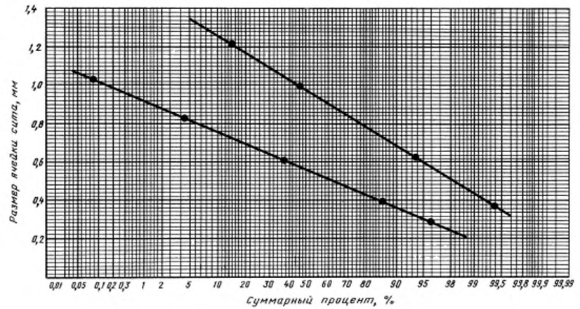

How can I get a function from this plot?
#2 Опубликовано: 06.06.2023 08:59:59
How can I get a function from this plot ?
1. Probably from the expensive digitizer suggested by Richard [Mathsoft Collaboratory]
2. Piecewise from Tracer.
3. Try Mathsoft digitizer.
4. Smath difficult
At this point from the collected data set, fit a model function.
Cheers ... Jean.

How can I get a function from this plot? 🖼
That is a straight line on a semi-log graph; you can reference this handout: https://inside.mines.edu/~epoeter/_GW/LAB/EquationsOfStraightLinesOnDifferentTypesGraphPaper.pdf
Per this handout, your equation should be
y = b + m*log(x)
where:
  • m = difference in y over one log cycle of x
  • b = y value corresponding to x=1
May this be of Good Help;
⚜ Kenny Lemens, P.E. ᵂᴵ
Hi. You can try this post Approximation of a functional curve in a digital image or this other one: Embedding images into a plot
Вячеслав Мезенцев 06.06.2023 14:16:00, Valery Ochkov 06.06.2023 13:45:00

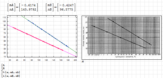

#6 Опубликовано: 06.06.2023 14:19:52
Hello Valery,
some Smath digitizing utilities
Cheers, Jean.

#8 Опубликовано: 06.06.2023 17:11:16
Hi. Hope this helps.
Modeling a functional curve in a digital image.pdf (860,39 КиБ) скачан 929 раз(а).
Modeling a functional curve in a digital image.sm (1 МиБ) скачан 1510 раз(а).
