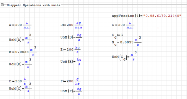

Hello
The unit operation snippet fails to detect units.
Snippet_Units_Fail.sm (33,04 КиБ) скачан 1407 раз(а).
Carlos
Carlos

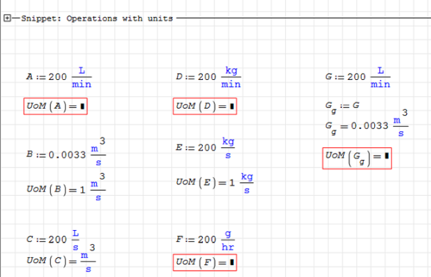

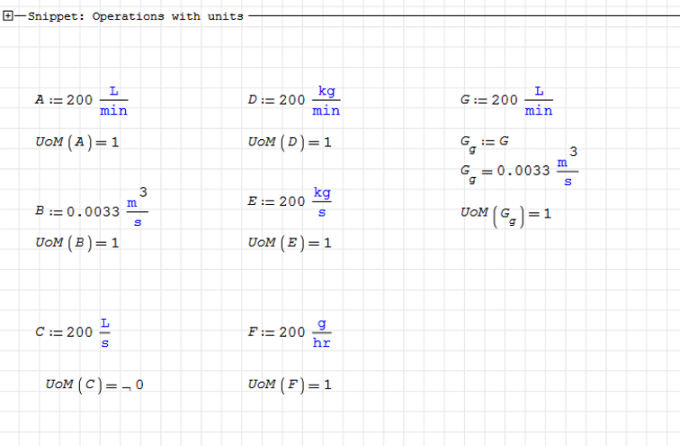

WroteHello David
Thank you very much for your answer, but the snippet fails, since instead
of finding the units, it only obtains the value of 1
My bad, IDK why but yesterday seemed to work to me, but in fact it doesn't. I'll give another look at the snippet ASAP.
I see the issue. The function look for a numerator/denominator pattern in the num2str() text, but doesn't handle cases in which multiple divisions are involved.
