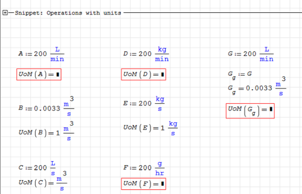

Hello
The unit operation snippet fails to detect units.
Snippet_Units_Fail.sm (33.04 KiB) downloaded 1671 time(s).
Carlos

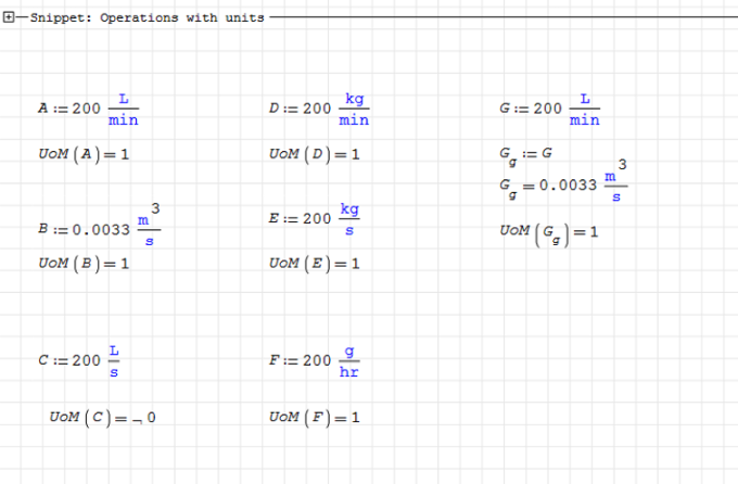

Thank you very much for your answer, but the snippet fails, since instead
of finding the units, it only obtains the value of 1
My bad, IDK why but yesterday seemed to work to me, but in fact it doesn't. I'll give another look at the snippet ASAP.
#6 Posted: 5/18/2022 2:00:44 PM
1,443 likes in 2,936 posts.
I see the issue. The function look for a numerator/denominator pattern in the num2str() text, but doesn't handle cases in which multiple divisions are involved.

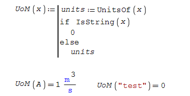

I'm not sure, however if you need a urgent fix here you have an easy way to make it working the same way.
