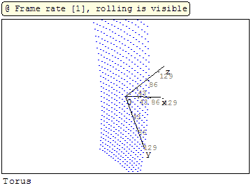

... it works, but it must be stopped dancing !
I figure some fixed Euler orientation must be applied ?

Hello Jean Giraud !
The calculation time will be greatly reduced, if the coordinates are represented as functions
x(t),y(t),z(t).
Torus Mod.sm (27,45 КиБ) скачан 1104 раз(а).
x(t),y(t),z(t).

Thanks Ber7 for doctoring !
Orientation is acceptable, ~ 3 minutes visit.

... updated
Torus.sm (33,61 КиБ) скачан 1095 раз(а).
... updatedGood work, Jean. I extended the animation to the full cycle.
