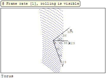

... it works, but it must be stopped dancing !
I figure some fixed Euler orientation must be applied ?
Torus.sm (24.31 KiB) downloaded 1125 time(s).

The calculation time will be greatly reduced, if the coordinates are represented as functions
x(t),y(t),z(t).
Torus Mod.sm (27.45 KiB) downloaded 1104 time(s).

Thanks Ber7 for doctoring !
Orientation is acceptable, ~ 3 minutes visit.
Torus.sm (33.61 KiB) downloaded 1095 time(s).
Torus Rolling.gif ... updated

Good work, Jean. I extended the animation to the full cycle.
Jean Giraud.sm (20.27 KiB) downloaded 1127 time(s).

Surface represented by lines.
Jean Giraud2.sm (19.82 KiB) downloaded 1087 time(s).
