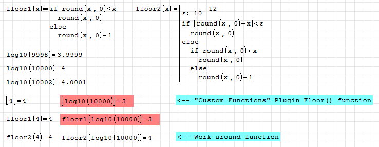

I think I found another quirky behavior.

However, the implementations of floor that I tried, do not return the correct value for integer powers of 10^x. As shown in my example.
It is because SMath returns 3.9999999999 (set the region to display 15 decimal places)

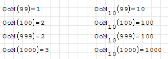

Let me explain what I am trying to accomplish. Maybe there is a better method.
For all numbers 100 to 999, I want the function to return "2"
For all numbers 1000 to 9999, I want the function to return "3"
And so forth.
Until is not fixed you can try with OoM(...) (order of magnitude) from Custom Functions plugin.
