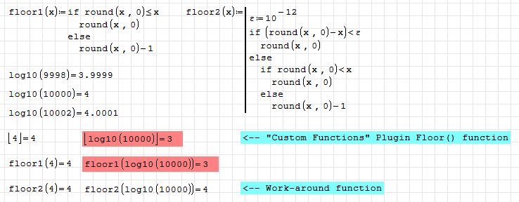

#4 Posted: 11/2/2016 7:50:50 PM
1,436 likes in 2,919 posts.
I think I found another quirky behavior.
It is because SMath returns 3.9999999999 (set the region to display 15 decimal places)

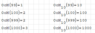

Let me explain what I am trying to accomplish. Maybe there is a better method.
For all numbers 100 to 999, I want the function to return "2"
For all numbers 1000 to 9999, I want the function to return "3"
And so forth.
Until is not fixed you can try with OoM(...) (order of magnitude) from Custom Functions plugin.
