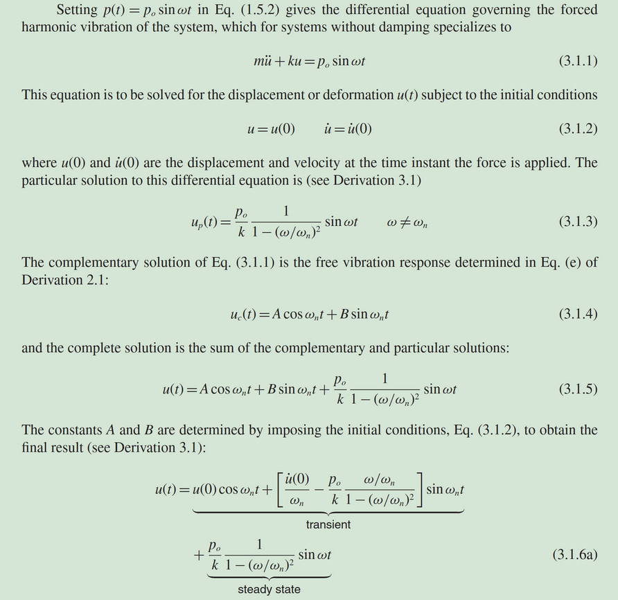

Thank you. How do you input ",u(t)" in the brace?

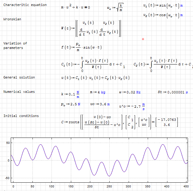

Plugin less solution, with units, using the Wronskian and the variation of parameters method.
Symbolic results from ODE.sm (23.52 KiB) downloaded 1388 time(s).
