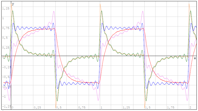

#7 Posted: 6/3/2026 6:22:44 AM
Hi Alvaro,
Since I'm not interested in the transient phase, I omit the first few oscillations from the simulation. “.tran 0 1000u 700u 1u” shows me only the 8th, 9th, and 10th oscillations.
With the integration used to calculate the coefficients “c(n;f)” for the square-wave oscillation, the calculation takes a very long time. There’s a faster way:
V1(t,f)
{4*V1pp}/π*sum({-1}/{2*n+1}*sin(i*(2*n+1)/2*ω0(f)*t)*e^{1*(2*n+1)/2*ω0(f)*t},n,-nmax-1,-1))+({4*V1pp}/π*sum(1/{2*n-1}*sin((2*n-1)/2*ω0(f)*t)*e^{i*(2*n-1)/2*ω0(f)*t},n,1,nmax+1))
I see you’ve really delved into the Laplace transform. As an engineer, I don’t want to get into the theory behind it—I just want to apply it to my problem. Unfortunately, that doesn’t always work, so I end up having to grapple with the fundamentals after all.
I’m still having trouble with your solution to my problem. But I’m working on it.

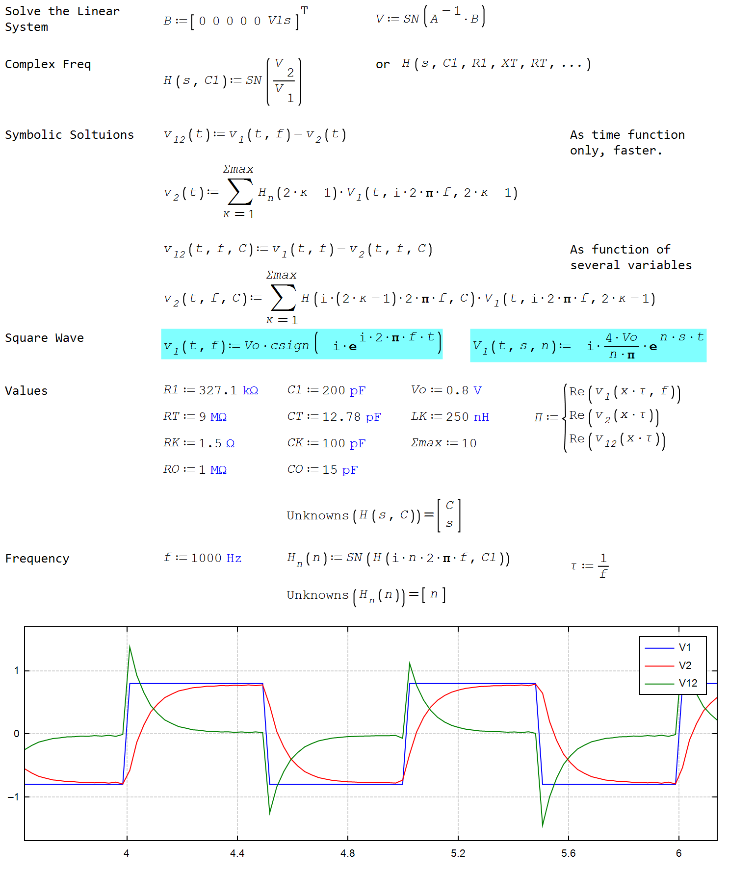

Hi Andreas. The solution for a square wave, using superposition method and admittance matrix.
Versuch mit R und C sqare.sm (30.43 KiB) downloaded 266 time(s).
Versuch mit R und C sqare.pdf (544.96 KiB) downloaded 286 time(s).

Hi Andreas. What the previous worksheets show is how to use the superposition principle once you have the frequency-domain expression for the circuit. The MNA function finds it, or you can find it by hand.
In the case of this circuit, the symbolic expression for v2 is
-{RT*(s*LK*(((RT*(1+s^2*CT*LK)+s*LK)*(RT+R1*(1+s*RT*(CT+C1)))-(1+s*CT *RT)^2*R1*s*LK)*RO+R1*(1+s*CT*RT)^2*(-(RO+RK*(1+s*RO*(CO+CK)))*(RK+s*L K)+RO*s*LK))-(RO+RK*(1+s*RO*(CO+CK)))*(-(RT+R1*(1+s*RT*(CT+C1)))*RK*RT +(RK+s*LK)*((RT*(1+s^2*CT*LK)+s*LK)*(RT+R1*(1+s*RT*(CT+C1)))-(1+s*CT*R T)^2*R1*s*LK)))*V1*e^{s*t}}/{(RT+R1*(1+s*RT*(CT+C1)))*(-((RT*(1+s^2*CT) *LK)+s*LK)*(RT+R1*(1+s*RT*(CT+C1)))-(1+s*CT*RT)^2*R1*s*LK)*RO*s*LK+(RO +RK*(1+s*RO*(CO+CK)))*(-(RT+R1*(1+s*RT*(CT+C1)))*RK*RT+(RK+s*LK)*((RT* (1+s^2*CT*LK)+s*LK)*(RT+R1*(1+s*RT*(CT+C1)))-(1+s*CT*RT)^2*R1*s*LK)))}
where V1 is the Laplace transform of the input voltage, which for a square wave is -i*{4*Vo}/{(2*k-1)*π}
The expression may seem very complicated, but only because it derives from inverting the circuit's admittance matrix, which is simpler to understand. What calculations have you planned by varying C1?

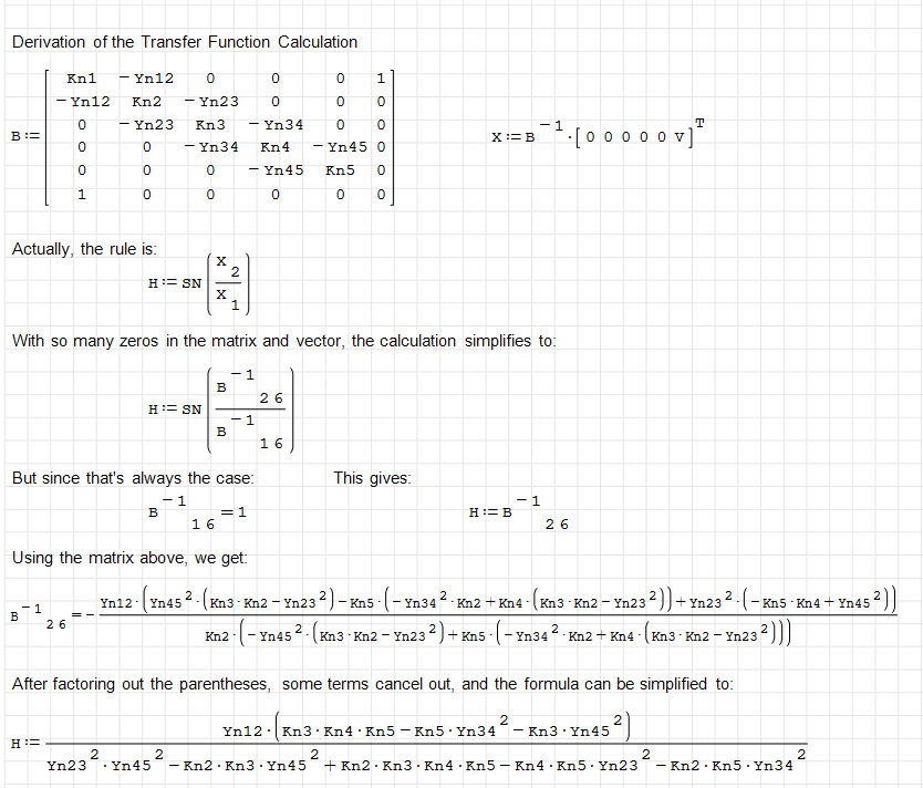

Hi Andreas. SMath's symbolic functionalities are somewhat limited; however, it does allow for several manipulations. I've attached some examples of how to perform electrical measurements in the case of a square wave.
Versuch mit R und C sqare measures.sm (78.34 KiB) downloaded 253 time(s).
Versuch mit R und C sqare measures.pdf (706.69 KiB) downloaded 227 time(s).
Regarding the file you attached, you can't simply invert a matrix with numerical admittances, as it contains mixed units of electrical potential and current. However, you can use the S function, which, in the absence of a function that simplifies expressions, can be useful in several cases, and this is one of them.
Versuch mit R und C Sinus nach Alvaro.sm (501.94 KiB) downloaded 255 time(s).
However, the V1 that appears in column vector B must be in the frequency domain, that is, it must be the Laplace transform of v1(t) (I follow the convention that lowercase letters are for functions in the time domain and uppercase letters for transforms or constant values). The correct expressions for v1, v2, and i1 would be obtained by inverting the expressions in VI, that is, v1(t) = invlaplace(v[1],s,t). Sometimes Maple can do this; otherwise, you can use the numerical inversion function.

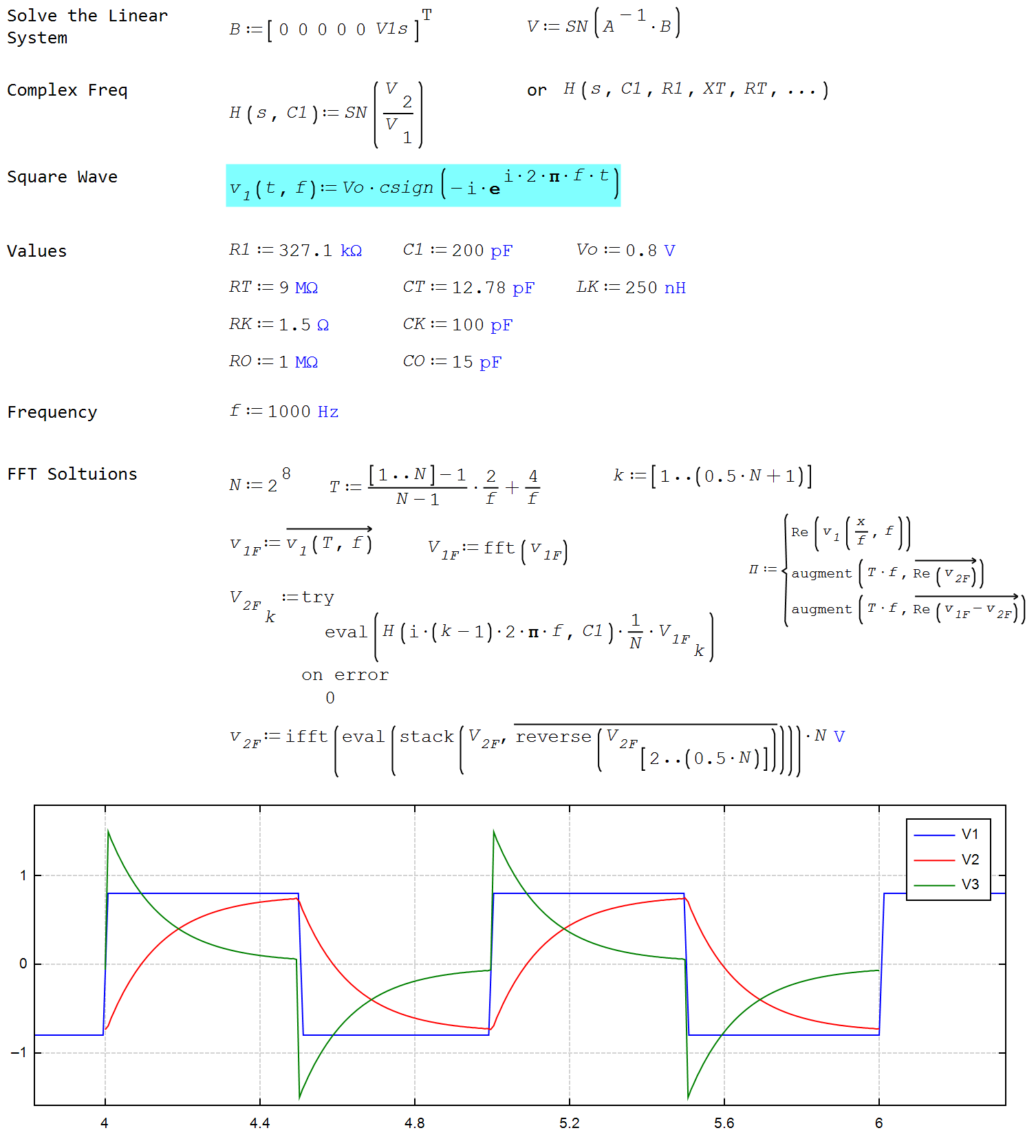

Another option would be to use FFT to solve the circuit numerically. If you're interested, I can show you how.
Another way is to use the superposition of solutions in linear systems, which is what I applied in the previous examples. That's where the summations come from.

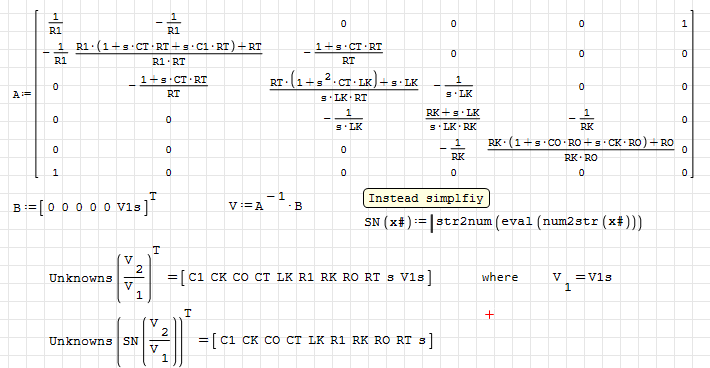

Hi Alvaro,
I've been struggling with Smath for a few days now, but I still haven't been able to solve a couple of problems.
First of all: What does the “SN” function do, and why do I need it?
It’s not necessary for “V := SN(A^{-1}*B )” and “H(s,C1) := SN(el(V,2)/el(V,1))”—it works fine without it. However, it’s absolutely essential for “H.n(n):=SN(H(i*n*2*π*f,C1))”. Even though the symbolic output of “SN(H(i*n*2*π*f,C1))=” and “H(i*n*2*π*f,C1)=” looks identical to me?!
It also took me several hours to realize that I had to set the loop variable “κmax” for the definition of the sum function in order to avoid getting the error message “κmax – not defined.”
Regards Andreas

#16 Posted: 6/18/2026 5:09:36 AM
Hi Andreas. SMath doesn't have a simplification function. I think I read about this method from Martin Kraska. SMath sometimes retains the internal operations, even though the evaluation shows the actual result. In this specific case, SN simplifies the expression by removing V1s from the numerator and denominator. Without using Maple or Maxima, I don't know if there's another way to remove V1s.
sn simplify.sm (13.03 KiB) downloaded 222 time(s).

#17 Posted: 6/21/2026 9:25:27 AM
Hi Alvaro,
well, I’ve been struggling with this for a few more days now.
First, regarding the SN function:
It seems absolutely essential to me when two functions are divided by each other. This is particularly true when determining a transfer function, when Fout(t;s)/Fin(t;s) becomes H(s) — that is, when the dependence on “t” is canceled out. Unfortunately, with H(s) — which is actually an H(t;s) — you can continue calculating through several steps without error messages, only to receive an error message at the end.
Graph of V1, V2, and V12:
Your graph reproduces the results of my measurements and my simulation very well. But the red V2 curve wasn’t calculated using the blue V1 curve. The blue V1 curve was generated from a sign function, while V2 was calculated using a Fourier series. For the nice, smooth V12 function, the sign function was then also calculated using the result of the Fourier series. Actually, the graph looks just like the one in the attachment.
Calculation of the Transfer Function:
In very simple terms, the transfer function is calculated from V2/V1, and then multiplied by V1 again to calculate V2. Why isn’t the V2 function calculated at the end identical to the V2 function used to calculate the transfer function? When comparing the two V2 functions (magenta and red), it appears that some smoothing or filtering has taken place. Can’t this mechanism also be applied to the Fourier series V1 function to make it smoother?
Translated with DeepL.com (free version)
Regards Andreas

#18 Posted: 6/22/2026 5:01:34 AM
Hi Andreas
The function H is indeed the transfer function, and it depends only on the complex frequency, and possibly on some circuit variable, such as capacitor C1, but never on time, as you can see in the following image. The SN function is used to simplify its symbolic expression, which is quite long, and is used in the absence of a simplify function in SMath.
The red curve of V2 is calculated using the Fourier transform of V1, because that is the procedure. It doesn't have any smoothing algorithm, such as a Lanczos factor using the sinc function, or anything like that. The procedure applied is quite general and provides the "exact" solution, if we consider "exact" to be something involving infinite series. That is, it doesn't "use" v1(t), but all the information necessary to solve the circuit is in the Fourier transform function V1(s).
If you want the solution without using the symbolic Fourier transform, and you want a fast and reliable numerical solution, you can use the FFT of the input to solve the circuit.
Versuch mit R und C sqare FFT.sm (30.17 KiB) downloaded 224 time(s).
Versuch mit R und C sqare FFT.pdf (580.05 KiB) downloaded 186 time(s).
