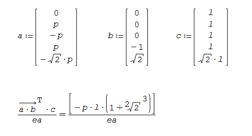

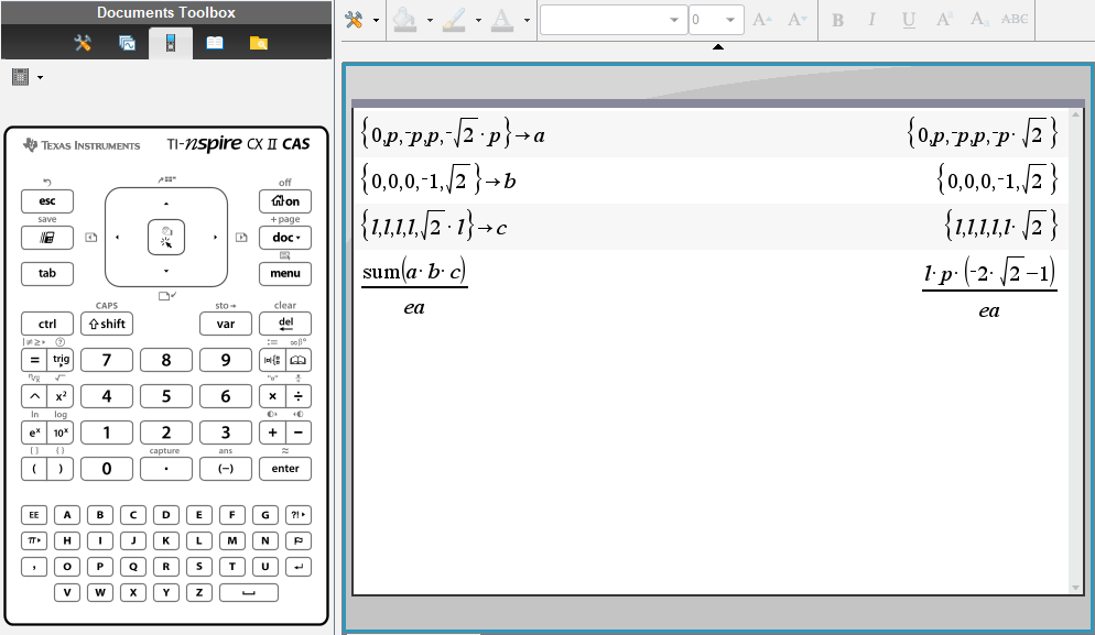

Hi~ I'm studyng building structural analysis.
When I calculate the displacement, I have to use list calculation like below using Ti nspire.
I would try this way in smath studio, but failed.
How can I calculate in smath studio?
thank you for your help.

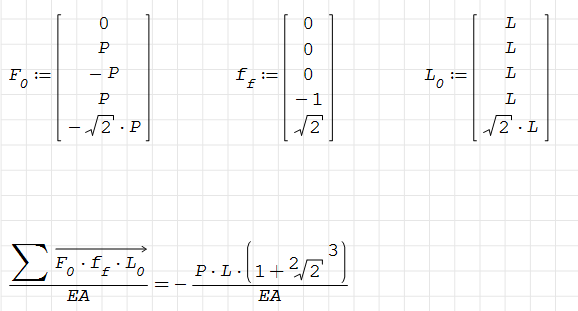

#2 Posted: 12/7/2025 9:23:36 AM
StvMath
StvMath
44 likes and 1 dislikes in 76 posts.
The following uses vectors rather than lists:
You beat me to it by seconds!

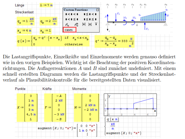

#4 Posted: 12/7/2025 12:34:43 PM
1,362 likes in 2,276 posts.
I have just submitted a book on Engineering Mechanics with SMath Studio for publishing. It is to appear early next year. The examples are already available at Github https://github.com/sn-code-inside/Technische-Mechanik-mit-SMath.
See example 5.5.
