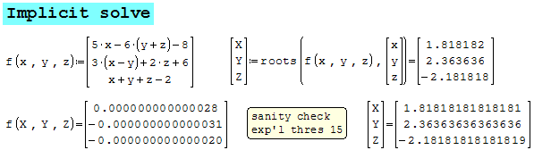

I have to solve a non-linear system of 6 equations and 6 unknowns and wanted to know which function is best suited to solve it.
The right answer is: give the system ... there are many ways.
Solve Algebraic.sm (73,6 КиБ) скачан 1096 раз(а).
Solve Algebraic, NON-Algebraic.sm (176,51 КиБ) скачан 1049 раз(а).
