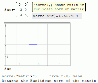

I want to plot a couple of simple scalar vectors. The question is like this: Sue walks 3 metres to the east, and then 5 metres to the north. What is Sue's displacement from her starting point?
How would I plot those two vectors in SMath? How would I then draw a diagonal line connecting the ends of those two vectors in order to calculate Sue's displacement from her starting point?
How do you change the scale of the 2D cartesian plot from the default 4, 8, 16 etc? I would like it to go 1, 2, 3, 4 etc.
Is there a way to draw lines within the plot free hand? This way, to answer the displacement question above, I could simply draw a line from (x,y) 0,0 to 0,3 and a line from (x,y) 0,3 to 5,3, then a diagonal line connecting the ends of these two lines which I could simply read the length of off the graph.
The length of a vector can be computated with the euclidean norm (wikipedia); do it for each vector you have, sum the results and you have the total displacement.
In a standard plot (type @ on the canvas) you can draw segments using matrices (x coordinates on the 1st column, y coordinates on the 2nd column); a path can be drawn with a single matrix or grouping single vectors with the sys() function (last element in the "Functions" panel on the right of your screen)
In the built-in plot is not possible. There are alternatives such as the X-Y plot available on the Extensions Manger (Tools > Plugins > Online Gallery).
Not available, sorry
How do you import reference books/interactive books downloaded in .zip format into SMath?
Downloaded from the wiki? You have to go to the "%APPDATA%\SMath\extensions\" path and do the job manually, you can use a regular download as reference to build new folders of the same type. The strange names of folders are unique IDs of each extension (you have to generate your own for things not available in the gallery

Hello, kernel.
So, I understand that you will kiss your girl friend if
you walk the right East/North distance while she walks a
lesser diagonal distance. What happens if both of you
end in the Pacific Ocean ?
More interesting: for spot testing of the camara objective
you will have to check the symmetry of the spot...
There is more about applying a correction matrix wrt the
mapping of the sensors.... Maybe a RemToDo in Smath.
More stuff in the attached.
jean
