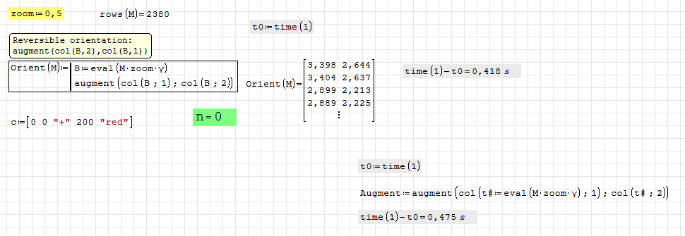

In many ways, Smath is hard to manage.
Few days ago, "augment, stack" were reported to be slow.
Yes they are and are not. Observe "augment" 2 cols [2380 rows]
~ 6 minutes compared to within program Orient(M) 0.016 sec [1/14500].
Most interesting !
Rotate Breather [Quaternion].sm (278,48 КиБ) скачан 1246 раз(а).

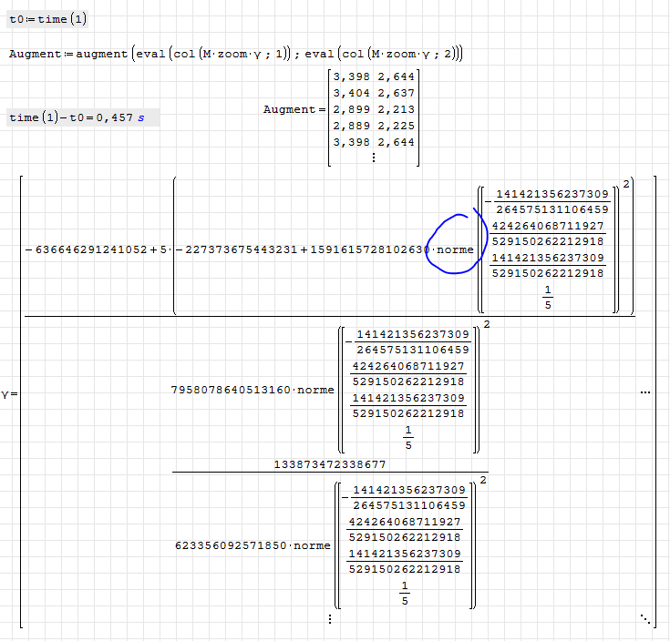

Is it really stack/augment, which is "slow"?
There are some functions, which are not evaluated at once, like "norme".
Symbolic evaluation of M*zoom*gamma takes 11s.
Maybe that's the real reason why it takes minutes.
Correct. You can see the difference in performances using the function Orient(M), where the product M*zoom*gamma is done at once and the numerical evaluation forced for all the matrix elements before any manipulation of his shape (col/augment).

You are not right about "norme", it is a peanut calculation stored as a new vector.
But it is calculated after "rotate(n,v)", stored as new vector as well.

Orient(M) => 0.015 sec [same: numeric/symbolic]
Numeric ... eval(augment(col(M*zoom*γ,1),col(M*zoom*γ,2))) => 2 sec
As a remark: "stack(,,) is much faster than "augment(,,).
Thanks for your interest ... cheers: Jean

My point was that calculation suites execute much faster when included in program.
15% faster?! (0,475/0,418)
#6 Опубликовано: 03.07.2017 10:10:08
... you are right: my timing of Orient(M) is just the timing to setup the program.
It must be compared as per your: augment(col(N:=eval(M*zoom*γ),1),col(N,2))
Thanks for that pertinent remark ! ... cheers, Jean
