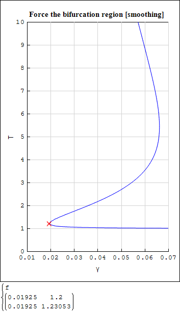

#12 Опубликовано: 29.06.2016 13:02:35
Fridel Selitsky
Fridel Selitsky
By increasing the limit values of the function  the graph does not
pass through a pivotal point
Bug.sm (8,2 КиБ) скачан 1201 раз(а).
#13 Опубликовано: 29.06.2016 14:31:53
That's right but not a bug. Just that above the Y magnitude 45,
the canvas misses some points in the critial region.
More: does not fill the circle, plots x instead of +
X_Y Plot wisely.sm (11,2 КиБ) скачан 1215 раз(а).
Fridel Selitsky 29.06.2016 14:37:00
#14 Опубликовано: 29.06.2016 14:38:02
