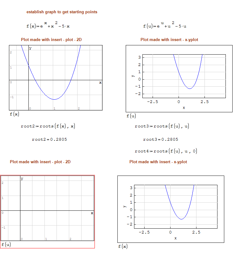

Hello Joe,
That is because you have to put "x" as a formal argument in the insert 2D plot (it is always "x" to f(x)). For insert 2D plot it does not matter if "x" is previously defined or not. XY plot works differently. It needs an undefined argument (f(x) and f(u) are the same as long as both "x" and "u" are undefined).
WroteI am not sure why SMath does not like insert - plot - 2D for f(u)
For the "QuickPlot" the plotting canvas argument is 'x' only 'x'.
You will have lot of pleasure plotting stuff in Smath.

Radovan / Jean:
I understand now.
