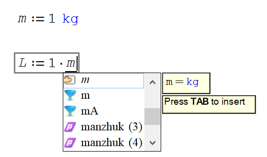

I'm used to typing the unit like this. I type, for example, m or kg and press tab. But it’s not a unit m, but a user variable m.
Check please!
You point a wrong problem.
There is no error. First "m" is the name of a variable named by "m", with the content affected by you of 1kg. The second "m" in blue is a unit name for the meter.

I type the letter m and then press the tabulator. The meters must be entered, not the user variable m.
The dropdown list of variables starting with the letter m can be disabled!
If I enter a variable m, then I don’t need to press the Tab key!
I wrote about this error to the developer!

Let's wait for the answer from the developer (Andrey Ivashov), who personally taught me that if I type the letter m and press the Tab key, I will get a meter.
Just type an apostrophe '. Then the placeholder switches from rectangle to oval shape and the dynamic assistant just displays units.
Even without typing the ' you can still use the dynamic assistant but you will have to navigate with the arrow keys before confirming your selection with tab.

What Mr. Ivashov says is true for most cases; open a new worksheet and keypress 「m」 + 「TAB⭾」, you will get the units m as meters (ie., 「'm」 ). The issue you are facing is due to your declaration of "m", thus your variable is added to the Dynamic Assistant and and since you typed in 「m」, it only makes sense that you are able to use the variable you created.
Maybe this will help you, what Mr. Ivashov said is a rough rule of thumb, the 'correct procedure' to enter in meters is one of the following ways:
May this be of Good Help;
⚜ Kenny Lemens, P.E. ᵂᴵ
WroteLet's wait for the answer from the developer (Andrey Ivashov), who personally taught me that if I type the letter m and press the Tab key, I will get a meter.
- Use the [Insert] menu ; [Unit...]
- Type the unit directly: keypress: 「'」 + 「m」
- Activate the 'Active Dynamic Assistance' (i.e., keypress: 「Ctrl」 + 「Space」)
- Scroll down until the desired entry has focus
- Keypress 「TAB⭾」 (or 「Enter⮐」) to insert item into worksheet
