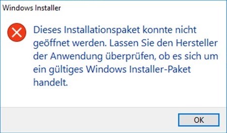

For some reason, windows blocks the Installation of SMath Studio.
While downloading, the smart screen filter already stops the download.
But while trying to install the program it is completely blocked.
Hope u can help me out here.
Google Translate:
"This installation package could not be opened. Have the manufacturer of the application verify that it is a valid Windows Installer package."

Thank you for the report.
Users are often experience this issue on IE because of Microsoft Smart Screen policies. I'm always contacting Microsoft and asking to fix this warning (I did it today again) and usually they remove their warning in two days afterwards.
The best thing one can do to help me regarding this situation is to inform Microsoft that url is safe. It can be done using this menu item:
The best suggestion I can provide is: please use any other browser except Internet Explorer (sorry Microsoft).

Turn off "smart filter" in internet explorer. I just ran into the same thing

I´ve reported that the program is safe.
The installing worked with turning off the smart screen filter.
But of course it would be nice to install SMath Studio without that scaring off.
