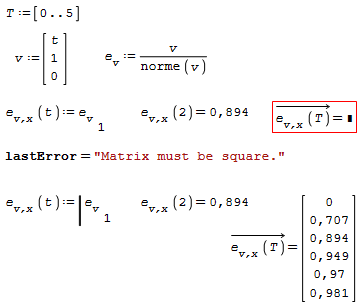

Why does the vectorize operation fail while it seems to be safe to use an explicit loop?

Is that just by observation or is there a fundamental obstacle?
WroteIs that just by observation or is there a fundamental obstacle?
Hi. I guess that it is fundamental.

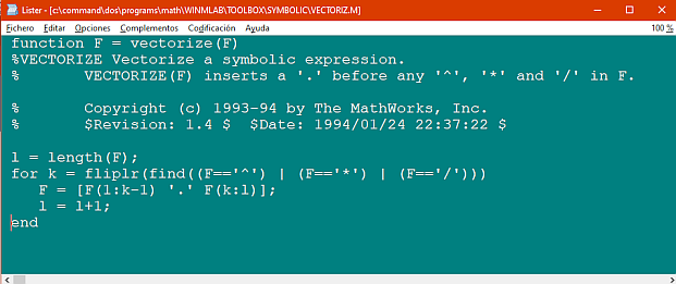

Pretty old matlab version, from its symbolic toolbox

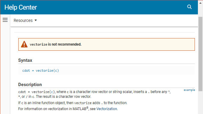

So, it looks like they have some issues with automatic vectorization.

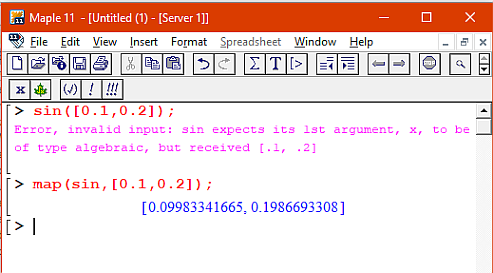

With maple it is very uncomfortable, you need to use map even for simple cases

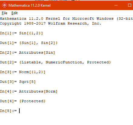

Wolfram's solution is very practical: Function with attribute 'Listable' expands over lists
But for make a table you actually need a loop or the Mathematica's Map function.

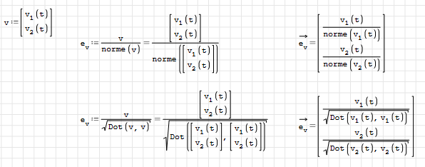

Set the demand in local definition mode ...
new(t):=|a(t)
vectorize and equate

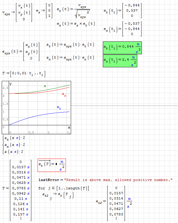

Thanks Alvaro and Jean. Here is a reduced working example.
When a scalar function involves scalar products then it must be defined in a line()-block in order to be vectorize()able.
Worksheet13.sm (5,9 КиБ) скачан 1601 раз(а).
