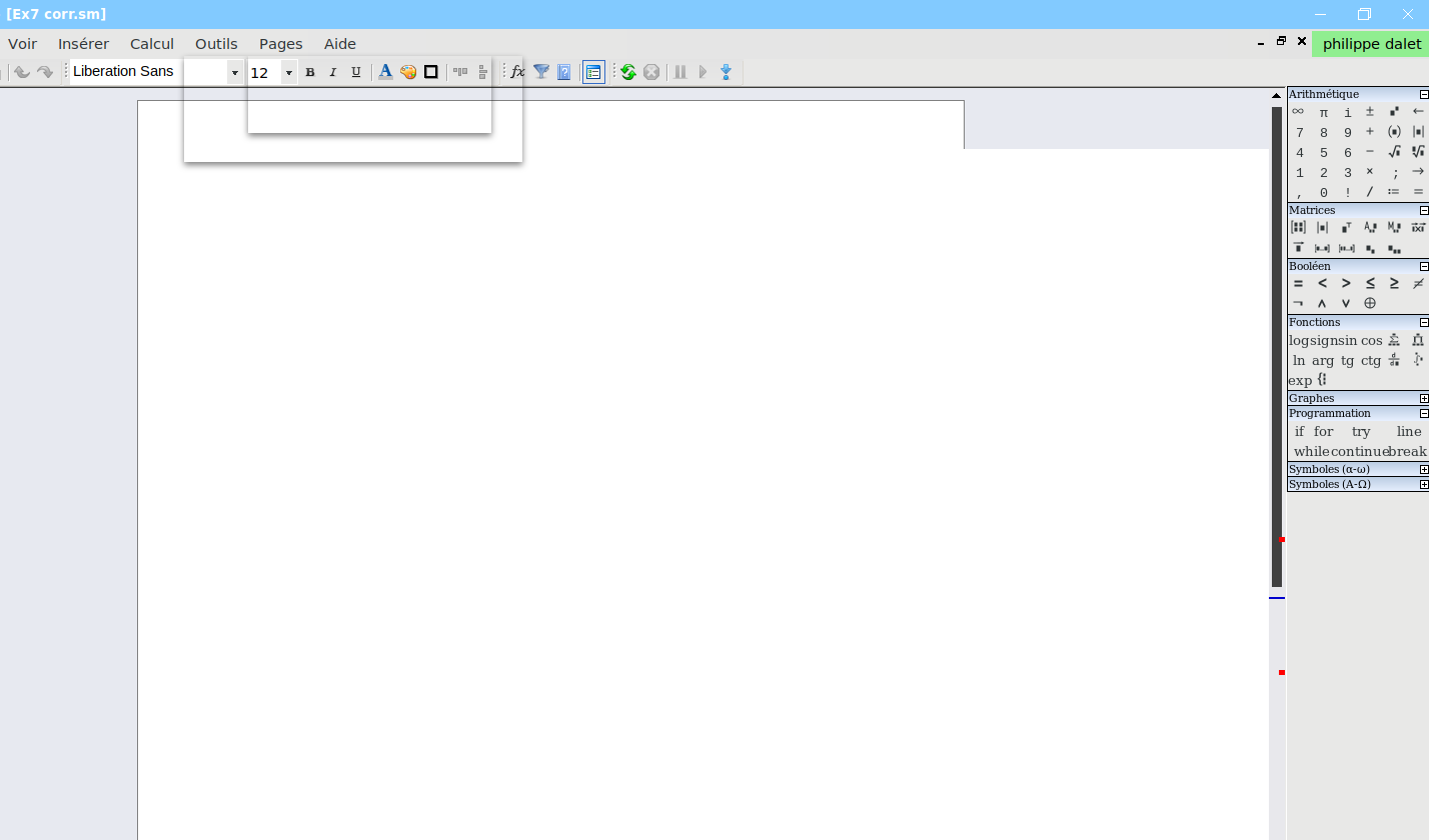

I can load a .sm file on Windows 10 (see joined files), but I have a big problem on linux (Ubuntu 20.04 64 bits - mono 6.12.0.122).
When I have loaded the file .sm, all menus disappears and the sheet displayed becomes bigger .
tested with
smathstudio 0.99 build 7786 and build 7778
Thanks a lot.

Please could you attach a screenshot from Linux?
#3 Опубликовано: 26.04.2021 18:59:21
philippe dalet
philippe dalet
18 сообщений из 34 понравились пользователям.
philippe

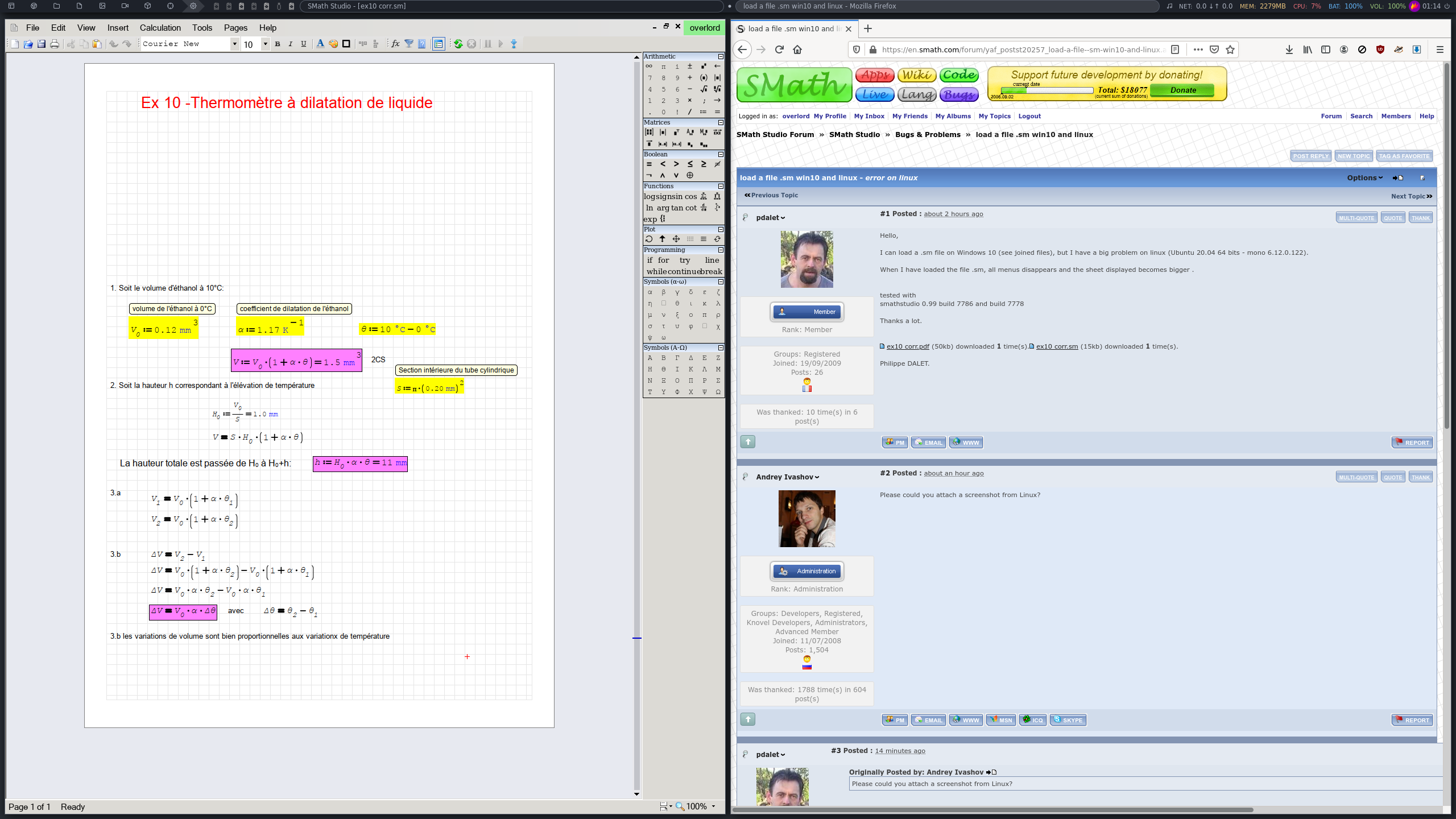

Nothing is wrong with my setup.

The file is a correction of a physical problem given to my students.
