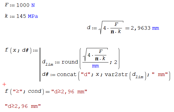

how can I solve simple inequalities, like the one below, in SMath Studio ?
Of course I could simply use equality sign to get the same result here but I guess that it's possible to do it normally as well.
Thanks in advance for your help

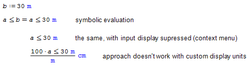

#3 Опубликовано: 23.01.2021 05:56:50
it's just a cosmetic solution
disuguaglianze.sm (5,31 КиБ) скачан 1044 раз(а).

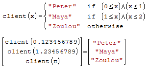

#4 Опубликовано: 23.01.2021 11:14:58
1 356 сообщений из 2 271 понравились пользователям.
A very limited native solution
Blatt2.sm (4,65 КиБ) скачан 1085 раз(а).
