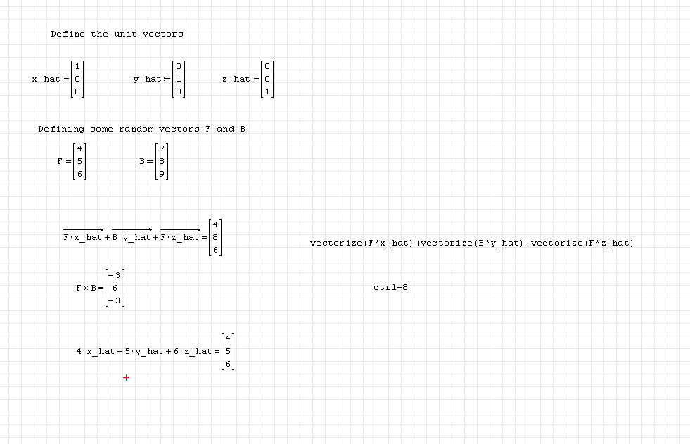

You can perform vector operations. See below. I don't think SMath has a way to put "hats" on the varaibles, but to Jean's point you can just use something from the character map. He used ALT+136 to get e_hat in his example.

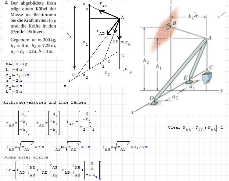

In the attached sheet, the attempt was made to solve some simple static problems using vectors.
If numerical values are given, this works to a certain degree.
The third, symbolic problem required a bit Maxima magic and manual copy and paste in order to get the solution.
There are some pages on matrix/vector operations in the interactive handbook.
13 Gleichgewicht im Raum.sm (196,02 КиБ) скачан 1120 раз(а).
