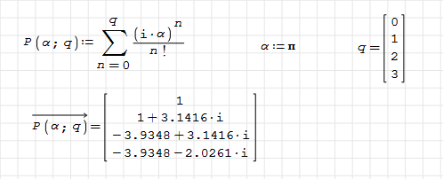

#2 Опубликовано: 05.07.2023 05:55:59
apha undefined + symbolic optimization

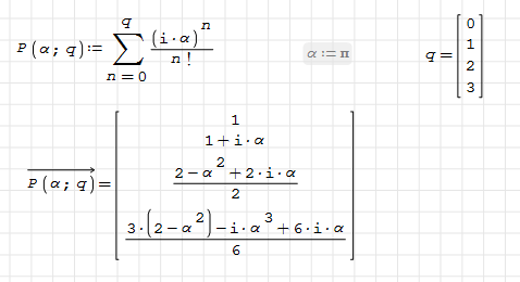

apha define + numerical optimization
