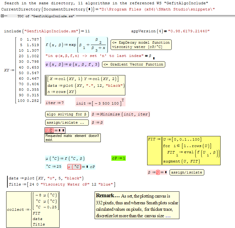

Hi Jean,
Thanks for your reply!
I tired the .sm file, but it doesn't work well. Meanwhile, the Genfit Algo Include.sm needs rename as GenfitAlgoInclude.sm.
I put the two .sm files in the same location, tSmath_error.pnghen I opened the Test Updated.sm, and pressed F9 to run....the error is shown in the picture.
The information of my Smath is Version 0.99
Looking forward to your feedback, thanks!
[attach]42964

I tried the .sm file, but it doesn't work well.
You have detected a bug wrt your SS version, maybe earlier ones ?
Silent Smath Community ?
If you open the governing Conjugate Gradient ... it could be
the symbolic module has not been saved Symbolic, a common bug reported.
By same token, I will delete all previous attachments.
Please, don't hesitate ... Take care ... Jean.
