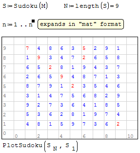

Hi. This other version stores all the intermediate steps in the brute force algorithm, but I fail trying to animate it. Hope someone else can do it.
SudokuBruteForceAnimated_lyles.sm (23,48 КиБ) скачан 1042 раз(а).
#26 Опубликовано: 05.09.2019 10:29:54
Thanks Alvaro for that gorgeous piece of work !
The "mat" style [n:=1..9] may have other applications ?
As it looks: left over from very original Smath versions.
In many instances SS 5346 needed mat2sys conversions
#27 Опубликовано: 05.09.2019 11:55:01
It's not an animation, but adding a Slider Region makes it easier to see solutions
SudokuBruteForceAnimated_lyles_raz_s.sm (25,18 КиБ) скачан 1017 раз(а).

#28 Опубликовано: 05.09.2019 12:18:58
Thanks Sergio ... near to RIP [I mean Sleep in Pace]
