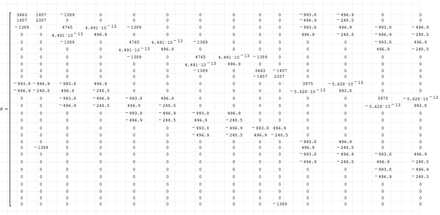

When inverting a matrix, I get a different output between (1) evaluating the inverse of a matrix and (2) defining a new variable as the inverse of the original matrix and evaluating the new variable. The outputs get worse the larger the matrix is. See attached images. Is this a bug in the matrix inversion algorithm perhaps?

Thanks, Alvaro. I've attached a screenshot of part of the K matrix in case that will spark any thoughts, but not sure if that will be helpful. I could upload the .sm file as well if that would be easier.
When you say one of the versions, you mean 'K^-1 =' vs 'Kinv = K^-1; Kinv = '. If it was a condition number problem, would you expect that to show up simply because we've defined a variable rather than evaluating without a new variable definition? I'm just specifically confused as to why:
K^-1 = one answer
Kinv = K^-1; Kinv = a different answer.
Is something happening related to the condition number when saving the inverse as a variable that doesn't happen when evaluating directly?
Thanks again for your thoughts.
K^-1 = one answer
Hi David,
From my point of view, your matrix looks like a stiffness matrix from a Finite Elements Method approach, if that is the case, I was working on that some time ago, and I found some issues trying to solve the equation [x]=[K]^-1*[F]. My solution was to use Gauss elimination or a solver for a banded version of [K].
Anyway, as mention Alvaro, it would be great if you attach your .sm file to check it.
