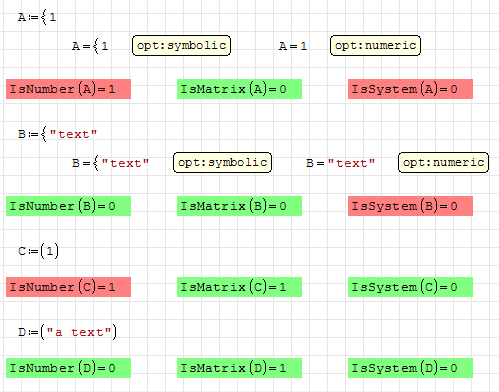

I'm very glad that you came back with a new plugin
Just as a feedback the IsNumber fails evaluating infinity and imaginary unit and there are some issues with single elements arrays/systems
