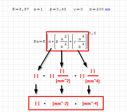

#4 Опубликовано: 02.02.2015 20:11:26
Maybe the attached picture helps a little bit more to understand the issue...
As stated previously, you can't sum apples and oranges; therefore the error message seems consistent...
