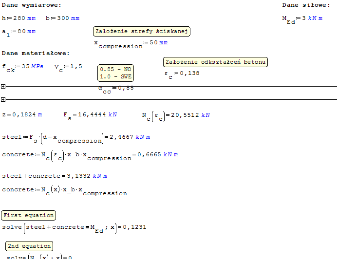

I have an equation, which depends on two other function, which depends on one variable. How can I solve it?
Look at the attached file. smath forum.sm (96,54 КиБ) скачан 1155 раз(а).
In general, I have set of two equations:
Fs=Nc(x)
and Fs*(d-x_compression)+Nc(x)*x_b*x_compression=M_Ed
Now, I implemented all funcitons as function of x (x stays for Ec - strain in concrete), but I can easily manipulate compression zone (x_compression) if necessary, as it is also not given as "constant".
At the beginning I define dimensions (b,h,a1) and material (fck, gamma_c, alfa_cc). I also assume compression zone and strain in concrete and I have bending moment M_Ed. Rest (and also x_compression and E_c) are editable/may change and depend on each other.
Could you please tell me what's the easiest way to solve those two equations?
Unfortunatelly, when I am trying to solve(Nc(x)=Fs,x)=0, SMath respond is that x has not been defined.
Any ideas?
BR.

For the needs of solving, you may assume that:
  • x_compression is given and constant (probably best for now)
  • x_compression is variable (but I should probably do it another way)
BR

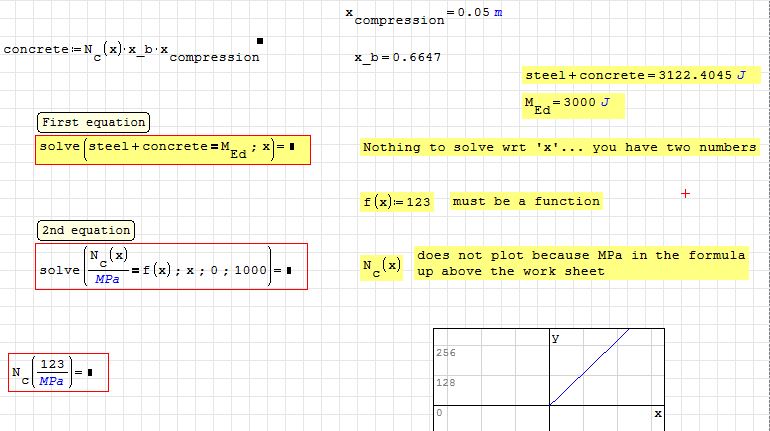

As it looks, units is the problem .
Some remarks at the end.
smath forum.sm (104,18 КиБ) скачан 1164 раз(а).

Jean,
thanks for your effort.
You have written:
"nothing to solve as you have two numbers" - not exactly, once you will look into the sum of steel and concrete you may see there Nc(Ec) - Ec is variable.
"f(x) must be a function" - isn't f(x)=123 a function? Still, I don't have any results. I would like to know at what argument Nc(x) is equal to Fs (Nc(x)=16.37, as then I may estimate strains in concrete. I don't know maybe you see a result? I have attached photo. Przechwytywanie.JPG
In the meantime I have prepared another set of equation for which I would need to have similiar solution as for that one above.
Could you take one more look at it?
BR.
Yes, and the answer is that there is no automatic solution.
Why ? Because the base "concrete(x)" is not a function,
only a discontinuous function, incompatible to the solver(s).
Done manually at the end of the work sheet.
Maybe "Dichotomy" is suitable ?
smath forum.sm (112,07 КиБ) скачан 1184 раз(а).
#7 Опубликовано: 25.02.2017 13:55:08
... "Dichotomy" solves nicely !
Solves for 'x' in "concrete(x)" for any value(s) in MEd(x)
Is it done as expected ? Your stuff is not my cup of tea !
smath forum.sm (116,76 КиБ) скачан 1218 раз(а).
