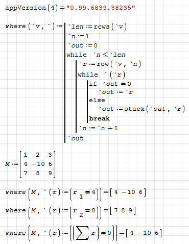

Эти функции нужно дорабатывать, т.к. они в новой версии программы не работают.
These functions need to be reworked, because they don't work in the new version of the program.

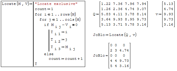

WroteHow can I find on the specific condition of the matrix line numbers or just to get a matrix with the right lines?
The example in the attachment.
Thank yo
The matrix truth table and associates might do and more.
Utilities Matrix Truth Table [Locate row_col].sm (33,41 КиБ) скачан 845 раз(а).
