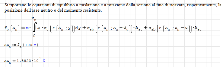

can someone help me to copy this mathcad code in a SMath's one?
I have some problems with the solution of Xn
Thank you
Thank you
Thanks Alvaro.

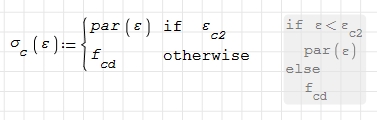

I made your correction, using the function cases(), but I have the same problem if I add other terms to fb(xn), for example if I add Ast*sigma sb(eps) and Asc*sigmasb(eps).
How is it possible?
Thanksverifica a flessione_prova2.sm (43,79 КиБ) скачан 1133 раз(а).

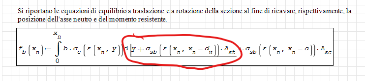

Possibly an odd bracket problem?
Here appears that Smath is making a group of "y+sigma bla bla" as object for the differential operator
So, fb(x) could not be evaluated.
I placed some brackets to clearly separate "y" from what follows in the equation, see picture below.
It appears that with brackets, fb(x) can be evaluated (but I get an error on units).
Maybe some other formula needs to be checked before?

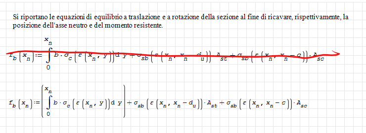

I am pretty sure my units mismatch correction is not suitable.
You should have to check this issue by yourself.
But I had managed to solve your function problem.
Rewriting it make function tick again.
verifica a flessione_prova2_rev.sm (45,02 КиБ) скачан 1215 раз(а).

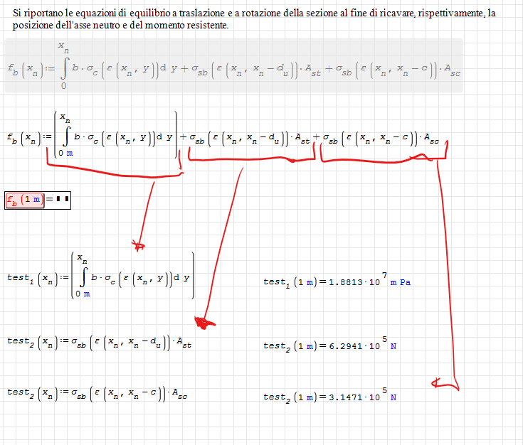

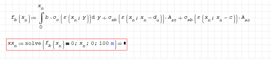

I've had this pending in background so I'll share the solution even here. Aside the initial issues about if() and units, the integral fails when x_n is set as 0, since epsilon is something/0. Therefore solve range must exclude 0 or the function has to handle it.
