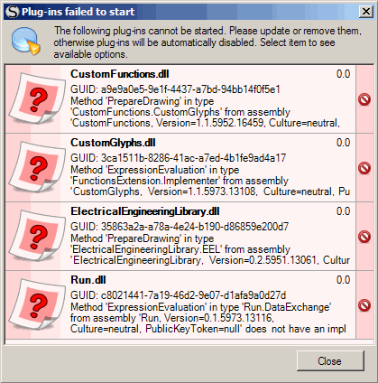

I'm XP SP3.
Downloaded 5935, installed msi in Program Files, in separate folder than 5346.
At this point, there is no plugins. Then donwloaded all plugins, open/unzip,
copy all dll's, pasted in 5935 plugins folder.
The installer installed the icon.
Like expected, some plugins are not active, fine...
... click "close" to open 5935, it opens. I can see the slider, the numeric up/down
is not there and so on. From the f(x), "Dot Numeric is there, fft, NOT mwxxx, not "cases"
and so on. open smath 5346 work shets NONE[ read NONE] of the 5346 open.

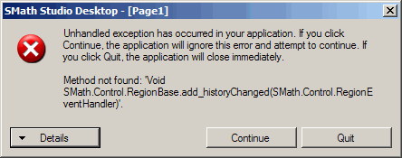

Just this mystic message
It will calculate ln(2) and maybe few more ... quick plot is dead @ ... I can see the
vectorize operator and the blue bar across the scroll bar ... the slider works...

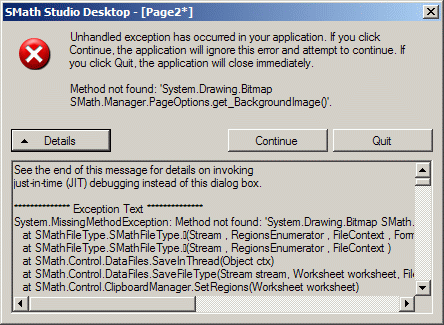

Whatever else, I get more mystic messages

I'm XP SP3.
Like expected, some plugins are not active, fine...![]()
I can see all the working plugins in the folder and from the 5935 work sheet
What the hell is wrong. As it looks the "Plugins Manager" does not manage much.
For what 5935 does to me today, I don't need. Hope some way to rescue, will wait
a day or two and attempt XP Restore. If dead: will catch the next wind for hell.
Cheers, thanks in advance, Jean.
Note that by installing 5935, it zapped the icon of 5346. All the former 5346 plugins
are the in the folder but 5346 is all dead and all the work sheets.
The correct way to update is:
Download install latest MSI overwriting current installation (in you case, since since you were doing some manual stuff, completely uninstall SMath and remove folder in user/appdata).
Once the latest version is installed open it up. Go to plugins - > online gallery (include beta versions). Update all plugins highlighted purple.
You are good to go.
Anyway if you do NOTHING by hand (unzipping / pasting) you are very likely to encounter ZERO problems.
And remember, in Soviet Russia you do not mess with software, the software messes with you!
P.S.: I apologize for crude humor, hope no one got too offended here.
