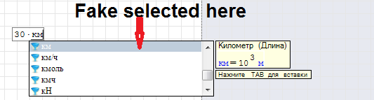

For example,
i type "30" then type "км", get dropped listbox, then push enter. so i got км - неопределено
Then
i type "30" then type "км", get dropped listbox, then push arrowdown, then push arrowup, then push enter. so i got normal blue kilometers

This is by design.
By default Enter means "leave focus from region". But when you starting to work with suggestions list explicitly meaning of the Enter button changed to help you make a selection.

Then list_box is dropped, zero item is seems to be selected. so if i leave entering enter, i expect my choice should been applied.
Anyway, what is the difference between "км" and "км" as dimension?
And why various items of list_box requires various actions: double-click on zero item and push arrow buttons for the rest items (much more comfortable, because i have not grab the mouse and double-click on item already chosen)

To use selected item you just need to press Tab. Enter is to leave a focus from Region.

I just want to type
V:=30km[arrow_right]/10min= # ignore popup
or
Скорость:=30км[arrow_right]/10мин= # ignore popup
or (with selecting item of popup by k/b )
V:=30km[Enter][arrow_right]/10min= #problem is no 'km' in smath, but should be?????
Скорость:=30км[Enter][arrow_right]/10мин= #fist item seems to be already selected, but in fact not
and get the result but not the error message of undefined type 'km' оr 'км', which should be defined
I want to get the result w/o using mouse or any other pointer. just keyboard
Interesting thought actually. It seems I need either to:
  1. show selection only if written text is exactly the same as shown in the list;
  2. replace written text with the one selected in the list as soon as list is closed (even if no Tab or Enter pressed).
Seems reasonable, I will handle it soon.
