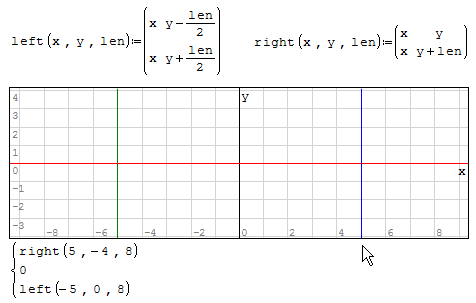

#1 Опубликовано: 09.04.2016 21:46:09
Mike Kaganski
Mike Kaganski
This demonstration (functions inspired by Jean) shows the problem:
С уважением, Михаил Каганский

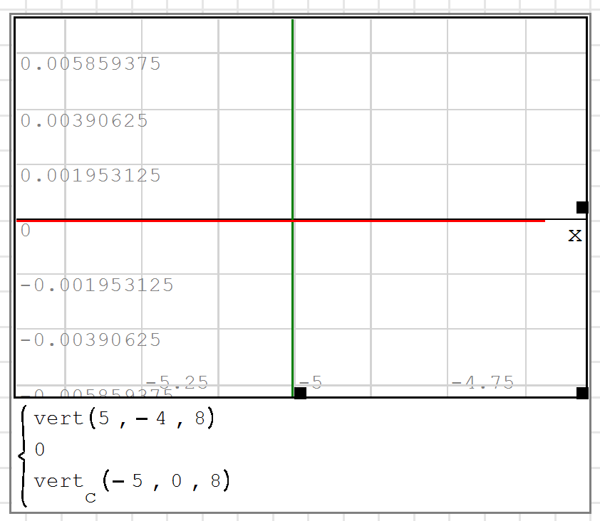

#3 Опубликовано: 10.04.2016 00:02:25
Mike Kaganski
Mike Kaganski
I assume you are using plot 2D.
Yes, you are quite right. Sorry for being forgetful - off-by-1.sm (5,53 КиБ) скачан 1242 раз(а).
Mike, in lieu of screen shot, usse appVersion
Thanks again! I still hasn't quite got used to this new handy feature.
Mike, how did you zoom in?
Entered the graph, then used Ctrl+Wheel (vertical zoom) / Shift+Wheel (horizontal zoom) while keeping mouse over the graph.

It's a zoom graphics issue. If you zoom into the axis, the "Line" is right over the grid line
I just redid an old Gateway laptop ... Linux Mint 17.3 and Windows Vista 32 bit. Your file and my file are identical in the graphics ... when I zoom in, the "line" is clearly over the grid. Look at the zoomed in graph 2D Graph.smz (3,11 КиБ) скачан 1278 раз(а).
BTW, thanks for showing me that the descriptor can be moved. Still figuring out how to do it right as I did it by double clicking on the right edge. Sometimes it goes to the right, others to the left ...
#5 Опубликовано: 10.04.2016 00:31:07
Mike Kaganski
Mike Kaganski
No, looking at zoomed graph, and enlarging screenshot, I still see the offset.
... the descriptor can be moved. Still figuring out how to do it right as I did it by double clicking on the right edge. Sometimes it goes to the right, others to the left ...
When you enter the descriptor, it shows three vertical dots to the left. You may grab these and move horisontally.

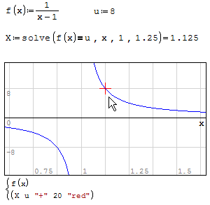

I think this would be a second example. I've tried to stretch and zoom in as feasible.Graphics off.sm (3,96 КиБ) скачан 1193 раз(а).
From what I can tell, the error is in the "arrow" size ("20" )[Change the arrow to an x and it shows the same error]. If I make it 1, it appears to hit the right number. This would need to be fixed as it "shows" the wrong location.
The only way to make it "look" correct, so far, is to use a "+" sign.

Anyone else seeing this issue?
#13 Опубликовано: 13.04.2016 11:15:57
There is no issue in there, just plotting coincidence wrt graphic package.
Coincidence that appears in any system. The only symbols that will "center"
on a plot trace are:
(X,Y,".",size,"color")
(X,Y,"o",size,"color")
(X,Y,"+",size,"color")
Davide Carpi 13.04.2016 14:04:00
#14 Опубликовано: 13.04.2016 11:57:36
... in your example, @ 'u = 8' the solution is exact.
As long as in any way you stretche the graph canvas
and the grid 1.125 is present:
the triplet trace/XY grid/symbol will coincide.

#16 Опубликовано: 13.04.2016 14:06:25
Correct; also, you can use "*" and "x" (wiki: https://smath.com/wiki/Graphs.ashx#SpecialPlots)
Цитата
  • Special characters (case sensitive) have position fixed on center on the given coordinates: + . * o x;
  • Words, phrases or non-special characters have top-left corner of (virtual) textbox fixed on the given coordinates;
ElSid 13.04.2016 15:22:00
