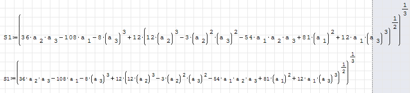

Sometimes expressions get too long to stay within the margins. A way to split math expressions into multiple lines would be great for presentation of data in a clear way.

#4 Опубликовано: 18.03.2016 22:17:13
I would imagine Andrey could implement some sort of a wrap setting.
It is all text after all.
On the other hand, if your equation does not fit in a page, are we trying to do too much
in one equation? I did run into this issue myself and I ended up separating things
Easy in Mathcad, but might turn a blody mess.
Much easier to split in components in Smath and
lot more elegant.

Implemented (with some limitations) starting from SMath Studio 0.99.6619. More info here: https://en.smath.info/forum/yaf_postst12530_SMath-Studio-0-99-6619--14-February-2018.aspx

I didn't use this is Mathcad as well, but as I see from the Internet there was some special operator "+" which allowed to make a line break.
If it is a true, then answer is - no, it is done by absolutely different way. Equation uses standard operators. Break is supported for "+", "-" and "*" when it is possible to break equation where user wants.
In my point of view implemented approach is very convenient to use. This is implemented for cases when equation is larger then a paper size, so this is the only elegant way to show large equations.

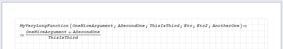

Hello everybody,
sometimes the definition of a function requires multiple arguments and if you want them to be "self-explaining" (at least to a certain level) you have to use meaningful names for those. All these conditions might bring to a long line before you can type ":" and start with a definition line.
At this point, the space on the paper for statements along the function definition might become a bit tight and the definition itself might be not printable(anything falling out of paper limit will be cutout in printing).
Any chance to have a split at ":=" in order to have the function definition beginning at the left margin of paper?
Something like:
MyVeryLongFunction(OneNiceArgument, ASecondOne, ThisIsThird, Etc, Etc2, AnotherOne):=
|A:= OneNiceArgument + Etc2
|B:= ThisIsThird * AnotherOne
|Calculation:= .....
|ToBeContinued...
Thanks for any help on this subject
Marco
#14 Опубликовано: 13.04.2021 16:21:43
2 335 сообщений из 4 034 понравились пользователям.
Группа: Super Administrator
Hello Marco.
Something like:
|Calculation:= .....
|ToBeContinued...
Yes, it is possible. After you have finished composing formula for definition just put the cursor before := and press Ctrl+Enter. This will produce something like
